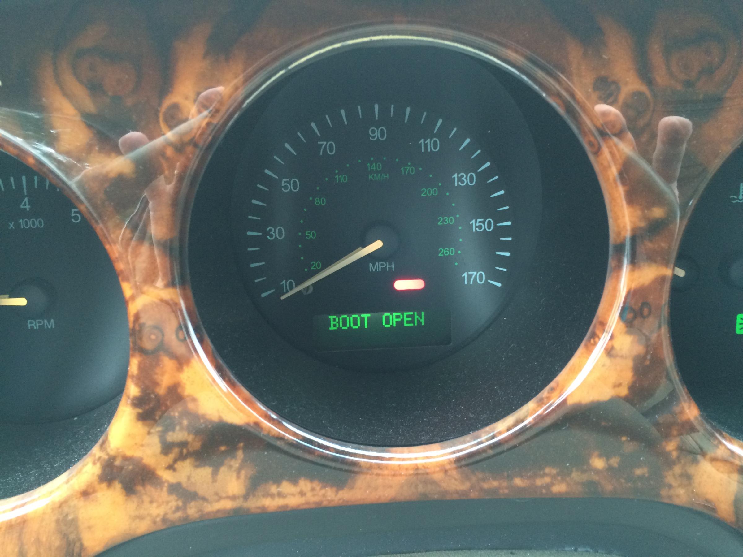

Gone a few months now without an eye catching message on my dash. It's been so nice. This morning was such a downer. I almost pulled jag back in garage and went to bed.

Accidentally hit the release somewhere? or perhaps a bad trunk switch?

Rather easily, you can take the trunk switch out from the lock assembly.
The actual switch is hold into a plastic housing (easy to separate), which also contains the latch assembly (the moving pin, which operates the switch).
With some luck, something is stuck or bent there.
I did mine just yesterday, as I had the reverse problem (switch did not always connect, hence the lights did not always go on).
Although the switch is sealed, I managed to spray some cab. cleaner into it, probable solving the bad contact.
Works better then ever before, at least for now.
I have a pic if needed.

LOL! the boot was not all the way closed, the mains leads were not connected, the tea and crumpets were not available...
Thanks! I shut the trunk and all is well with the green money pit.

On my first XJ8, I would consistently get the Boot Open message: after six tries -- it was under warranty -- the dealer's tech finally found a frayed wire in the the loom along the hinge.
I get it almost as frequently in the new one -- with arthritis in both knees, I am gripping the door, with fob between thumb and door, as I lower myself into the Jag, accidentally hitting trunk release . . .
