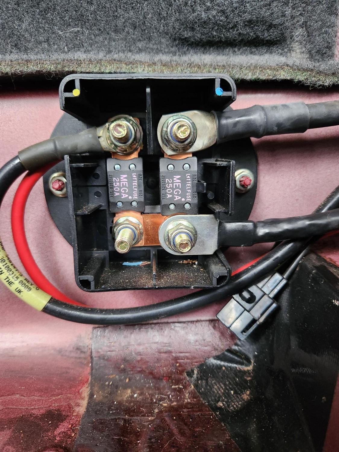

Well, it ain't the starter! Must be the alternator as it acts up when hot and it's been very hot around here the past few days. When it happens it's a huge drain on the battery; enough that the windows do not work or cannot open the trunk with the button. Removed the power cable from the bulkhead connector and things work again. I'd guess a diode is failing when hot and sucking down the battery? After a few hours when it cooled down I installed the cable and it started right up. Last time it acted up was when it was also very hot outside and I'd been driving it. Fortunately I was home when I tried to start it! I have another starter arriving today and will change it tomorrow. This better fix the car! Will post results....

It will most likely not be the alternator. This is what you need to check.
1) The ground cable under the engine.
2) The bulkhead connector on the passenger side rearward of the shock mount. Check both sides of the bulkhead.
3) In front of the spare tire just to the right is the mega fuses. It’s a little black box that should have a cover on it.
4) The positive battery cable from the mega fuses to the battery.
5) The negative battery cable.
What I listed above are likely to have.

Thanks for the message as those are all points of potential problems. I had removed the connectors and checked and put electrical grease on everything just in case. I did have that exact thing go wrong with the connection at the heavy fuse box on the XJR I had for a while so was familiar with the possibility I ended up changing the alternator so if that's not the problem, I suppose it will happen again! I am attaching a pix of the fuse box for you review as I do value our opinion.

Well, it ain't the alternator either! Not sure what is going on. When I turn the key, I get a click and the lights dim and the car does not start. Today I connected the volt meter at the battery terminals and the level was dropping. While that was going on I disconnected the power to the false bulkhead connector, the power to the two fuse boxes in the engine compartment, and the fuse box in the trunk..Still was going down. It stopped dropping at some point though I'm not sure what triggered the problem to end. I then reconnected everything and with the jump box attached, the car started normally. Will fool with it perhaps later today....
Whatever it is causes the power to drain from the battery. In the space of about 15 minutes it was down to 9 volts.

You were correct, it was not the alternator. The power cable in the right hand heel box was not very tight so once that was screwed down, there has been no problem at all! Finally, though it was a hard lesson to learn. As always, thanks much for the advice.
