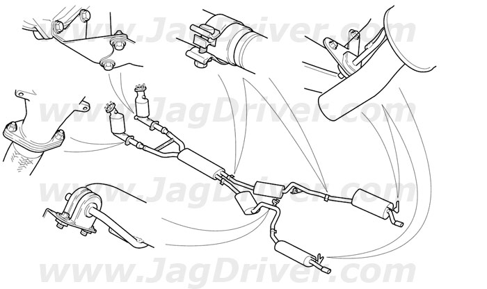

I pulled off my mufflers today to see how it would sound, surprisingly it was only a tad louder. So than I pulled the middle mufflers and got some sound out of it. Its a little much so I guess the other option is to leave the end mufflers and cut out the middle ones which would be really simple.. The only problem is I cant test it out without cutting and welding... Anyone do just the center mufflers and if so how does it sound? By center mufflers im not talking about the huge one after the cats..
What I'm thinking is since there even smaller than the end mufflers the difference in sound would be even less than no mufflers..kinda pointless IMO but at least it would be free and I wouldn't have to worry about tips and bending metal..

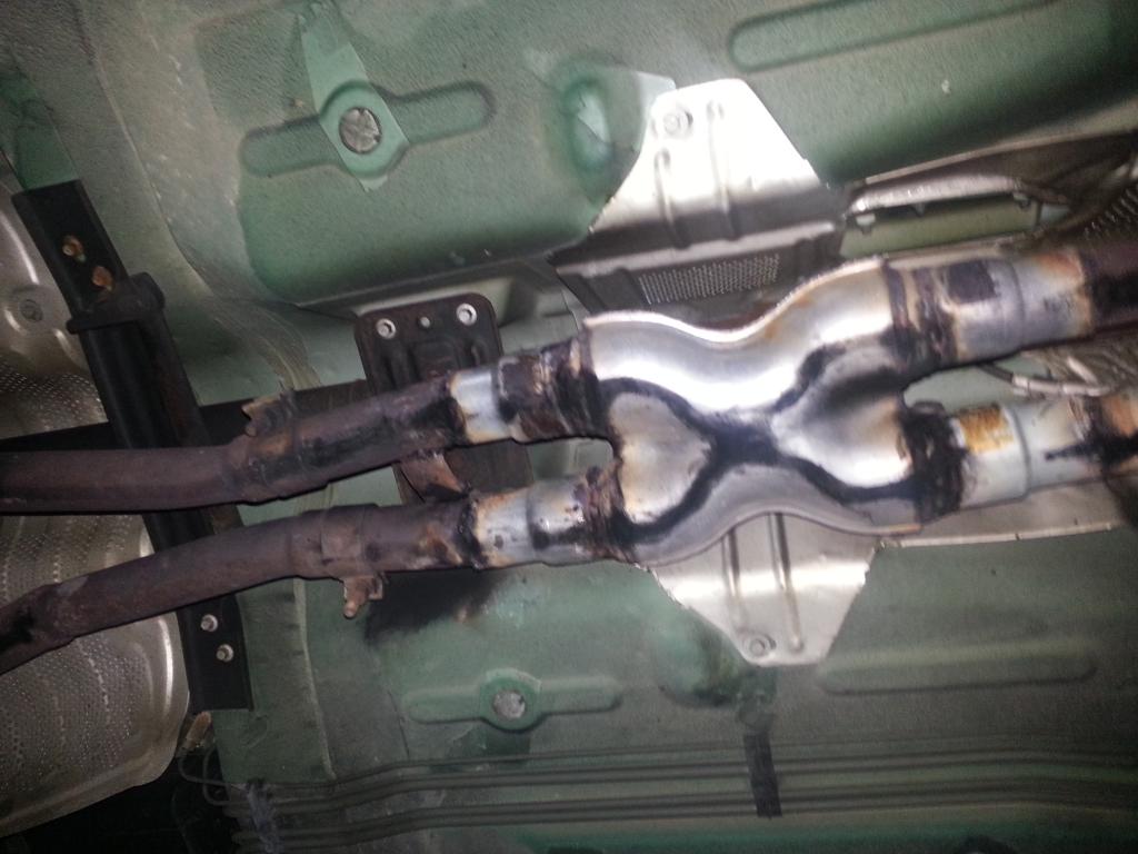

Attached Thumbnails Opinions on factory exhaust mods-20130126_172014_zpsvjhs98jt.jpg
Old May 15, 2014 | 09:59 PM
X308XJR's Avatar
Posts: 50
From: Burtonsville, Md
So your running x pipe which replaced the center muffler than which mufflers past that? How does it sound? Xj8 or R

my car is xjr
