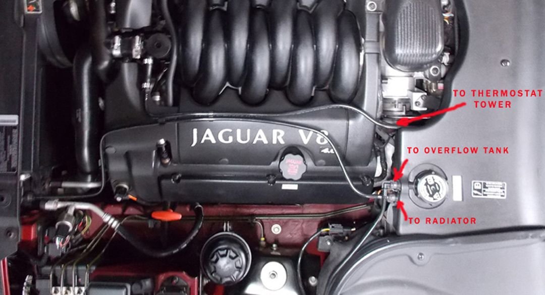

If there are two small lines from the expansion tank, they should cross at the tank.

Thanks all for help so far I’m not sure what the last reply means on the two lines from expansion tank .But I will ask the garage to test to see if the block is ok they said they have done a dye test which was ok .So should I ask them to fit a new thermostat as there isn’t one on the car and also a new water pump and coolant then see if any difference to start with .Then fan blowing fuse will probably be separate issue I’m not sure if he can swap motor off other fan to try for now as I haven’t a clue I’m just trying to get old girl fixed
The two lines close together at the coolant reservoir sometimes get connected to the wrong outlets, it is easy to do because the correct way looks to be crossed, but isn't. This is how the lines should be connected, and where they go to............

From: South Wales valleys
Oh great thanks for photo 👍
