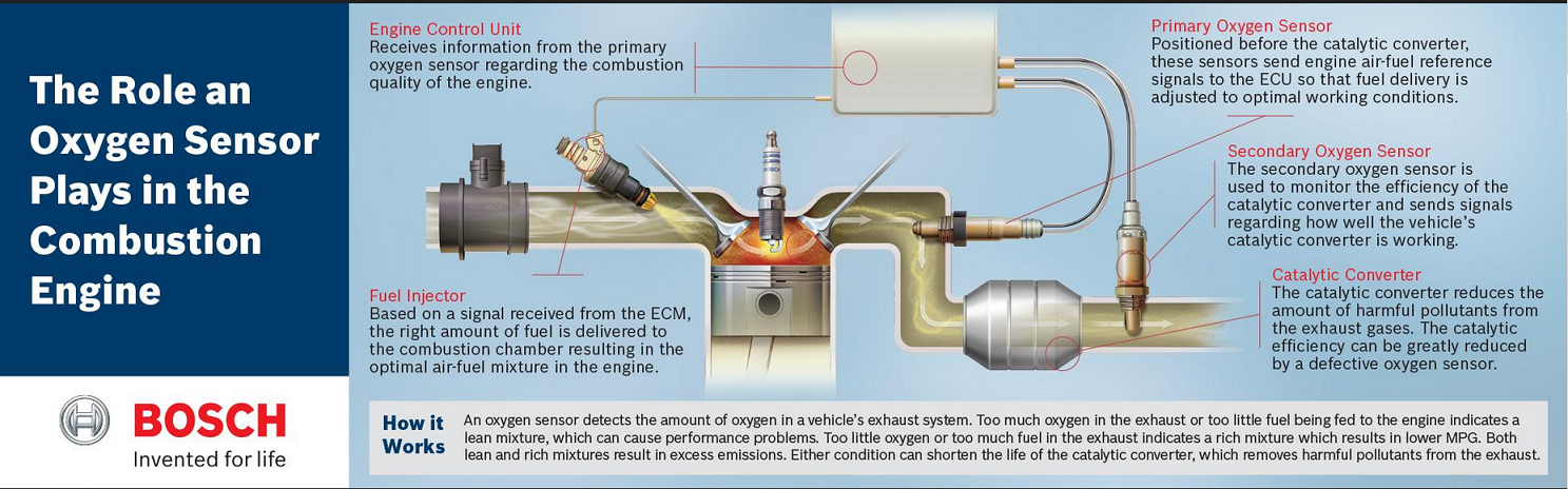

Are we sure the O2's are all good? Here's my install thread from the How To, make sure you have the correct O2's. Though that low idle shudder sounds more like a vacuum leak.
https://www.jaguarforums.com/forum/x...cement-195018/
Like I said in an earlier post, Ford components tend to have "hard" code issues.
For review....

Fuel trims good. Smoke test good. No codes. O2 sensors correct. Is there something I should look at in the live data? Do you know what the TP percentage should be at idle?

If it's running CL (closed loop) with a hot engine parked, at idle, LTFTs within about 5 of zero, all OBD monitors happy, then it's all good and the TPS is irrelevant really.

What exactly am I looking for in the live data to make sure the O2 sensors are happy? They obviously are happy enough to not throw a code. Also, just for S and Gs what TP percentage should I see at idle? It seems lower to me than other cars I have compared it to.

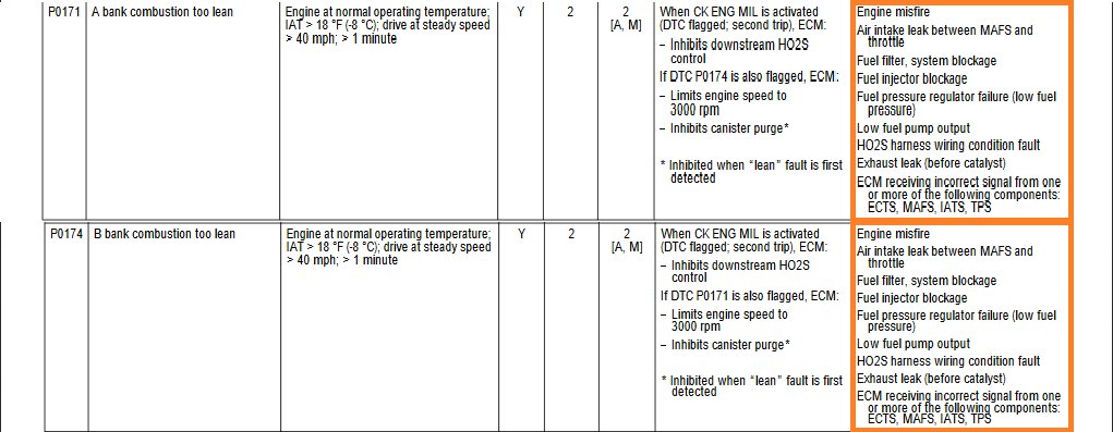

You state when you turn the wheels your idle gets worse, this really sounds like a vacuum leak.
Since you recently had the 171/174 issue, I suspect moreover the simplest scenario, possibly along with a vacuum leak....fuel filter...just make sure you've covered these other areas...
Here's some TSB pdf's for review....
