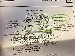

I am planning to check the electrical connector on the transmission and then start testing resistance at the pins...see attached pic for how the c1175 is tripped...it looks like this doesn't have anything to do with the wheel speed sensor, which I've checked and swapped .::
Also this is intermittent with little rhyme or reason...I'll be driving the stability/traction error message with a lit ABS light...even then very occasionally he gear box fault comes on and the tranny stays in gear....the gear box warning does not happen everytime I get the ABS light
After an ignition cycle the error goes away and abs light disappears after reaching 10MPH
Any other thoughts welcome

Dubious connection/wiring / failing bearing / etc - any of the usual failures for cars of its age. You know from C code roughly where to look.

- I've wrapped the wire going from my Gearbox to TCM with flexible heat shield fabric as the main heat shield that should have been attached to the gearbox was gone and I thought the wire overheating could affect its movement of voltage or resistance
- I've replaced the plug on the gearbox that the cable plugs into as when I disconnected the cable it did have some fluid in there on the pins, so I replaced it as I guessed one of the rubber seals was bad...
- when my mechanic went to change the plug the screw was stripped and the connector was slightly melted to the conductor plate...so I had the whole conductor plate changed, which includes the hall effect sensor which was one of the items I thought could be causing this issue so that has been ruled out as well
