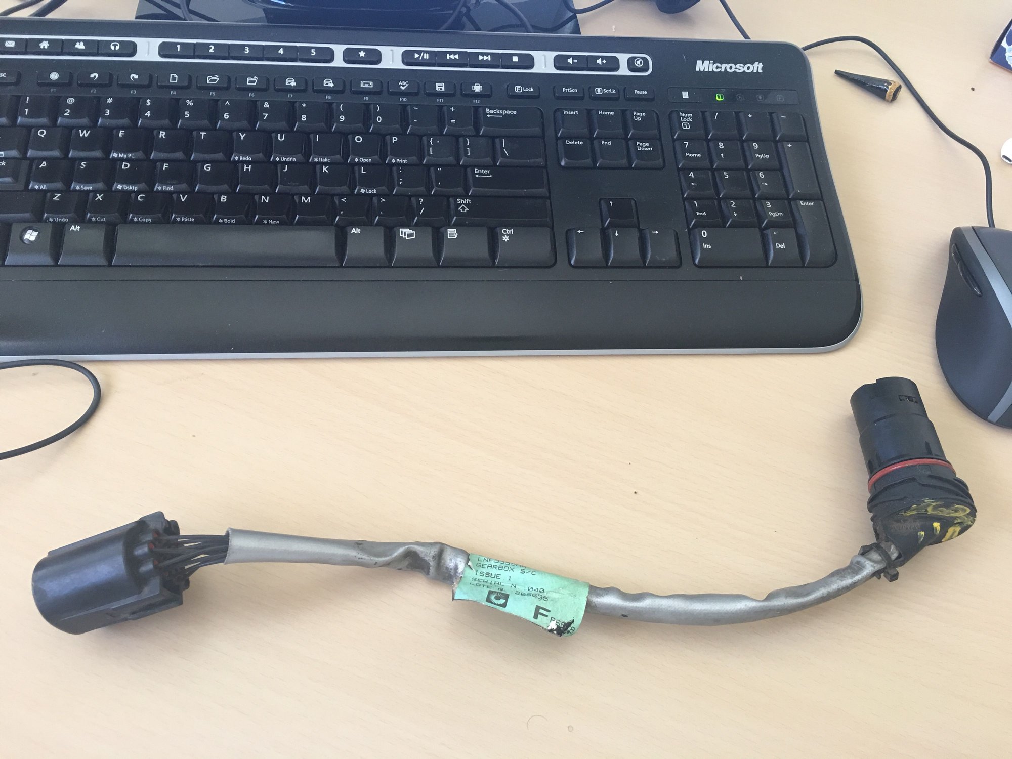

ok i finally got a replacement cable from the gearbox to the TCM...well it goes from the transmission to the main engine harness....PART NUMBER = LNF3355AA
so i am hoping after replacing it, i'll be good...if not next step is the ABS module replacement...the cable is very short, and disconnecting it from the main engine harness is going to be tough, as the catalytic converters seem to block access...
