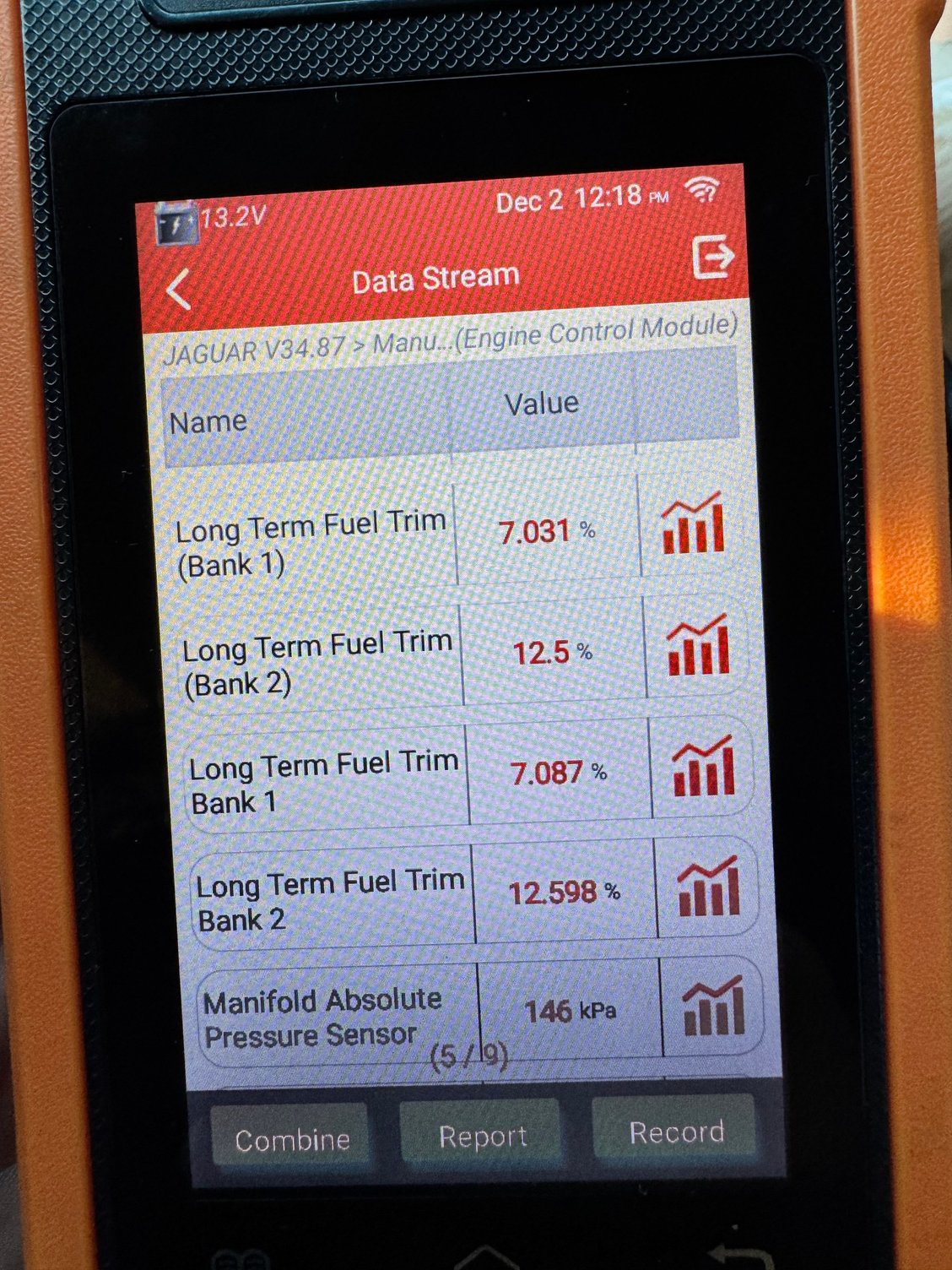

Seems to be running rich on bank two (left side): I guess I would start by cleaning: clean the air filter (or replace); clean the MAF and check each connector; clean the throttle plate and bore; run a can of Gumout's SeaFoam look-alike (or SeaFoam) through a can of gas.

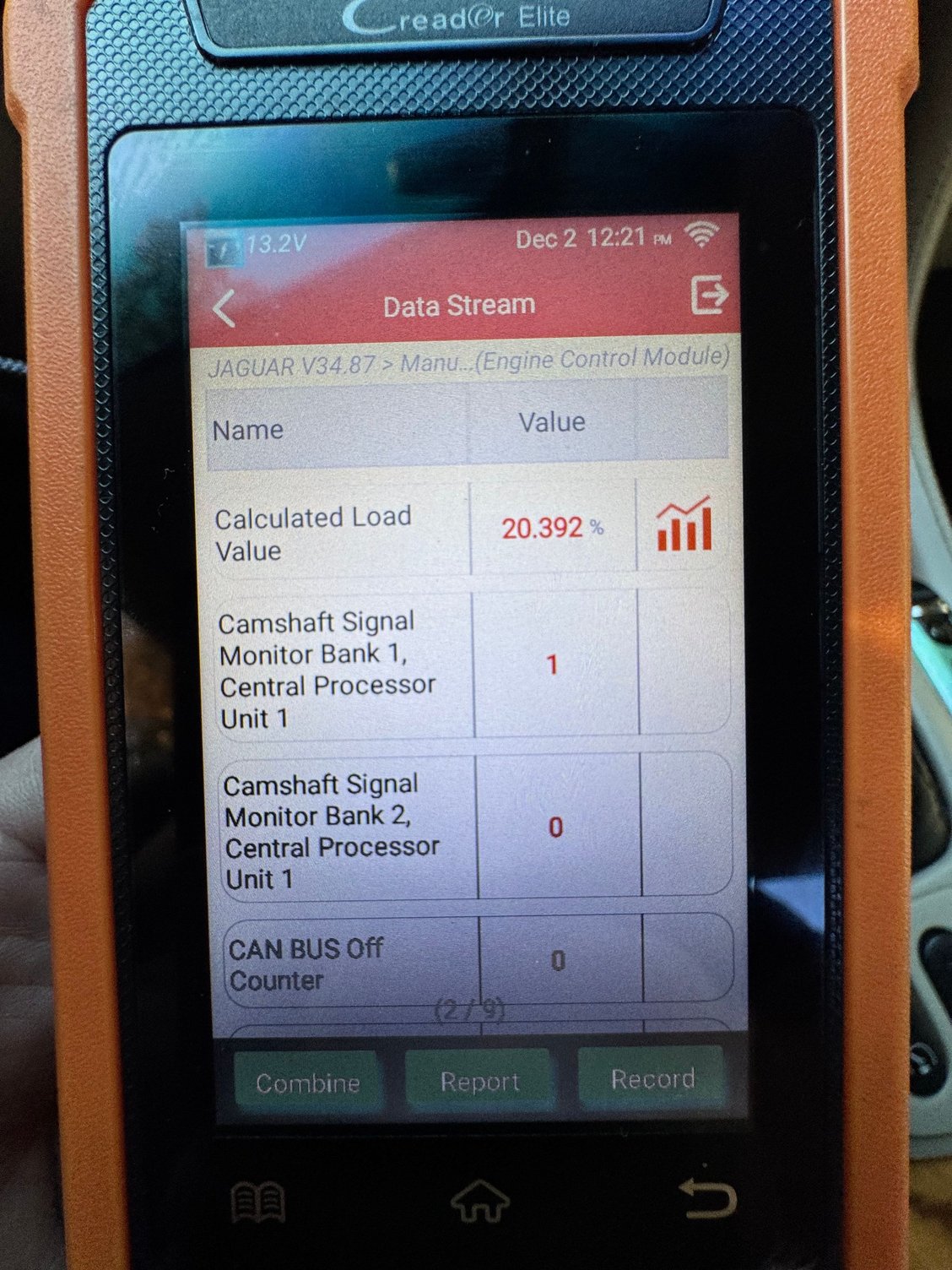

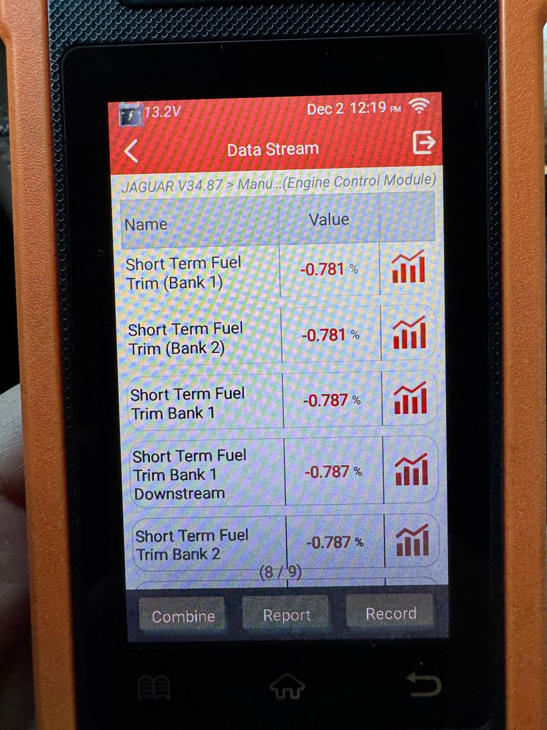

It would be nice to know wich cylinders are misfiring. After that you can pin point the reason better when you know are you missing spark of fuel or both or something else. Try to pull out injector connector on each cylinder while engine running badly to pinpoint the cylinders that are acting one(s).

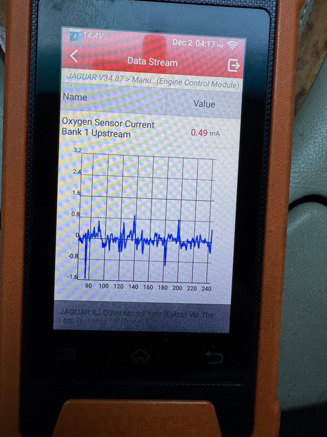

Oh I did not see the pictures. Rear O2 sensors aren't warmed up yet, so the mixture is not known yet. (Unless they are warmed up and stays bottom wich case engine is running very lean) 12.5% on long term trim is nothing severe on these cars. But on a high side that is for sure.

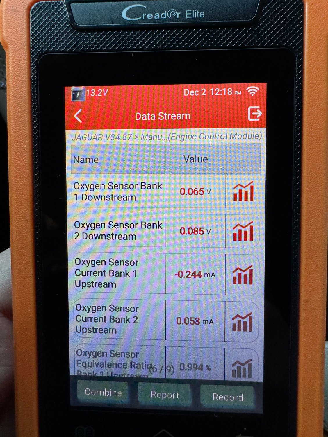

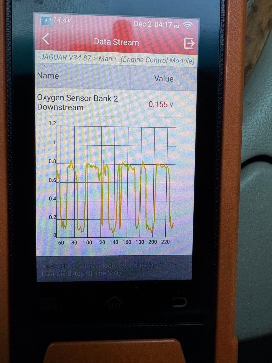

Downstream
Downstream
Upstream
Upstream
Getting weird O2 fluctuations.

Do you have catalytic converters installed ? When rear o'2 sensor voltage oscillates like that cat's does not work or are cold as can be.
Yes they're installed. That reading was while the car was warm and idling for quite a while. I was trying all day to try to figure out what the issue was so the car had been idling nearly all day.

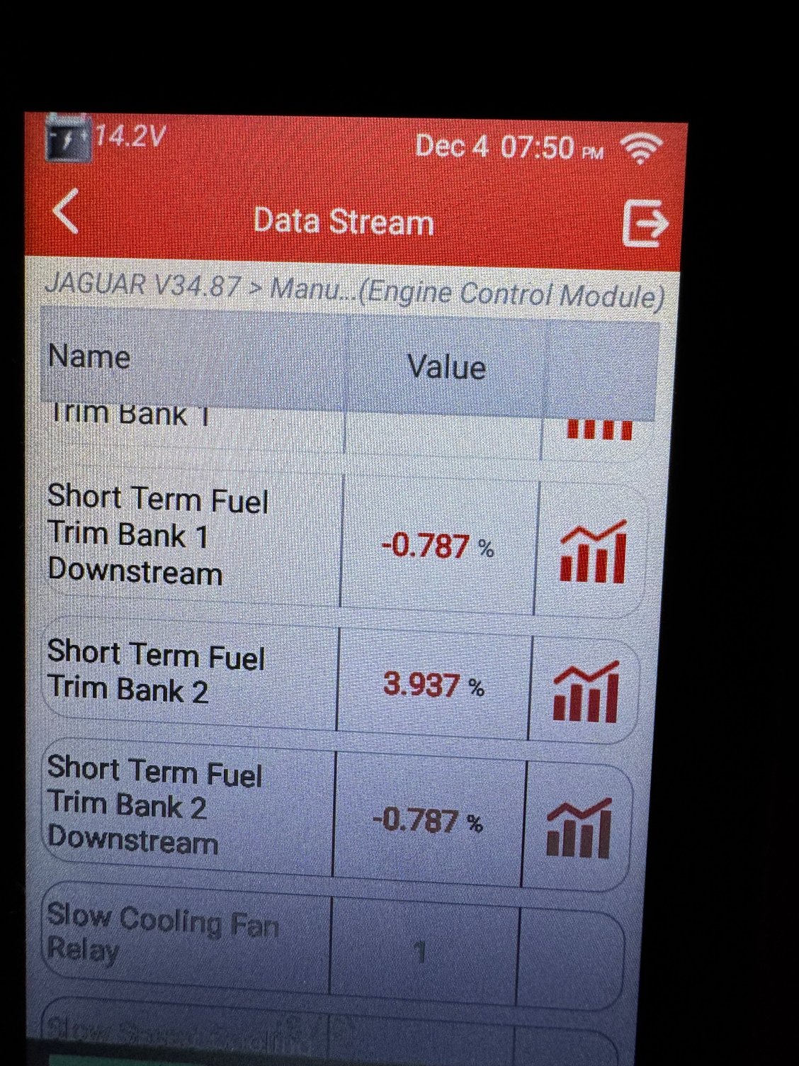

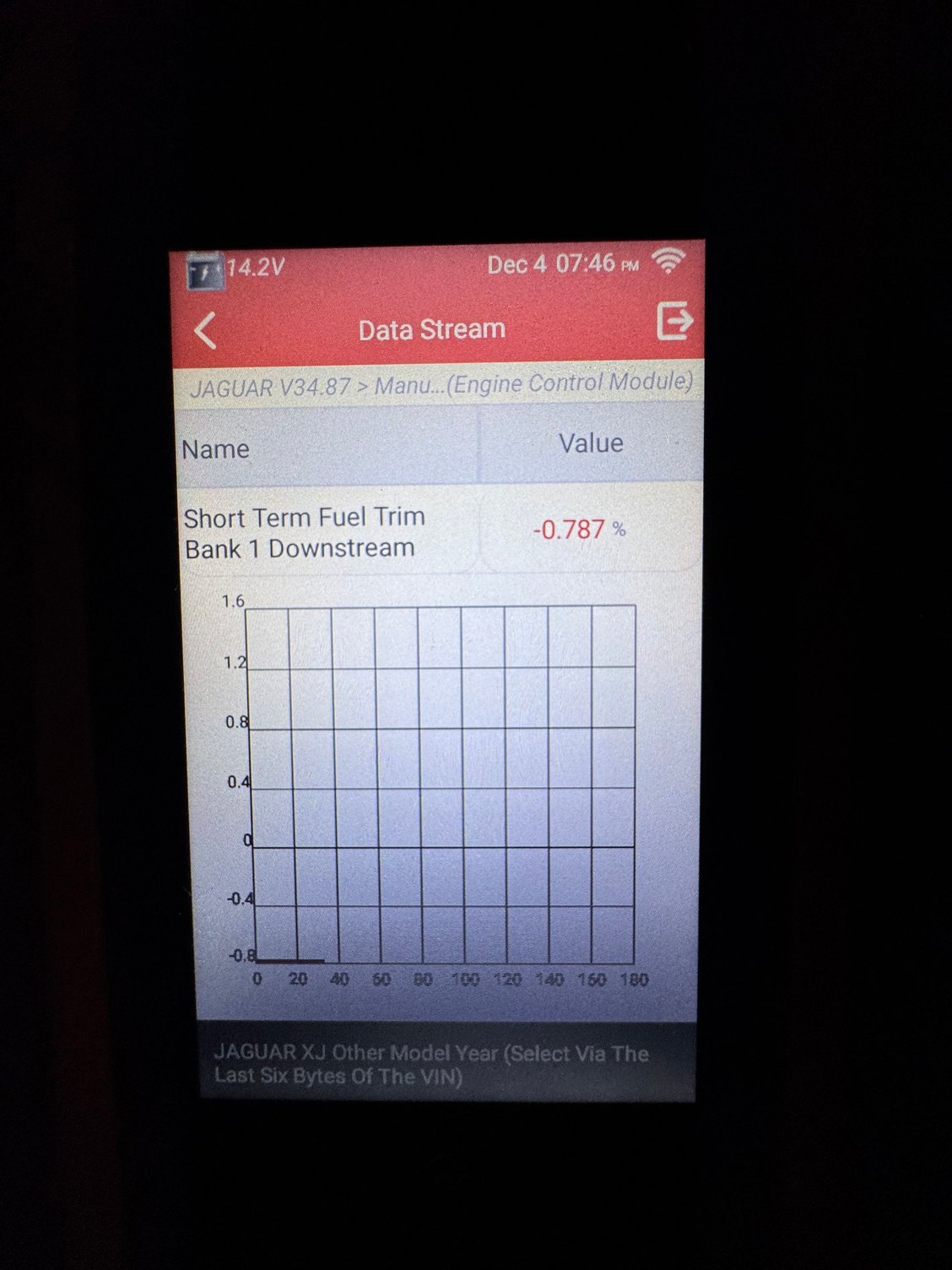

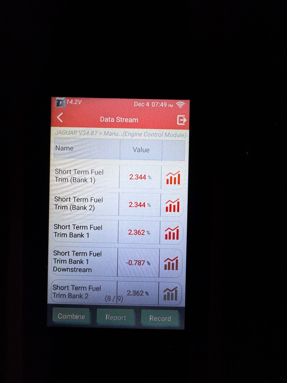

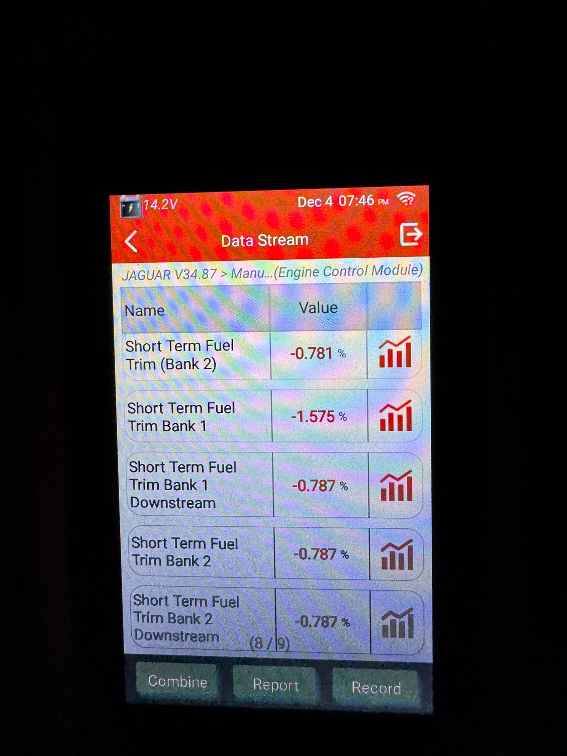

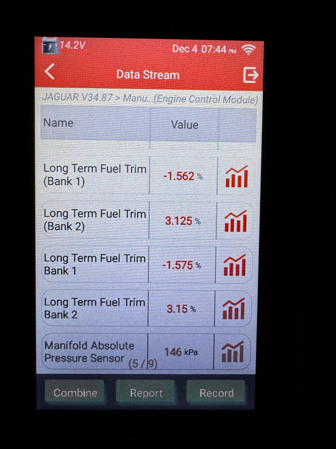

I am seeing different data now that may be an indicator. My fuel trims look a little better. But the idle shuddering persists in gear or out of gear.
My short trim fuel bank 1 and 2 downstream don’t seem to be moving at all while revved, in gear or idling. They’re dead flat at -0.787. I’m wondering if my downstream sensors are dead?

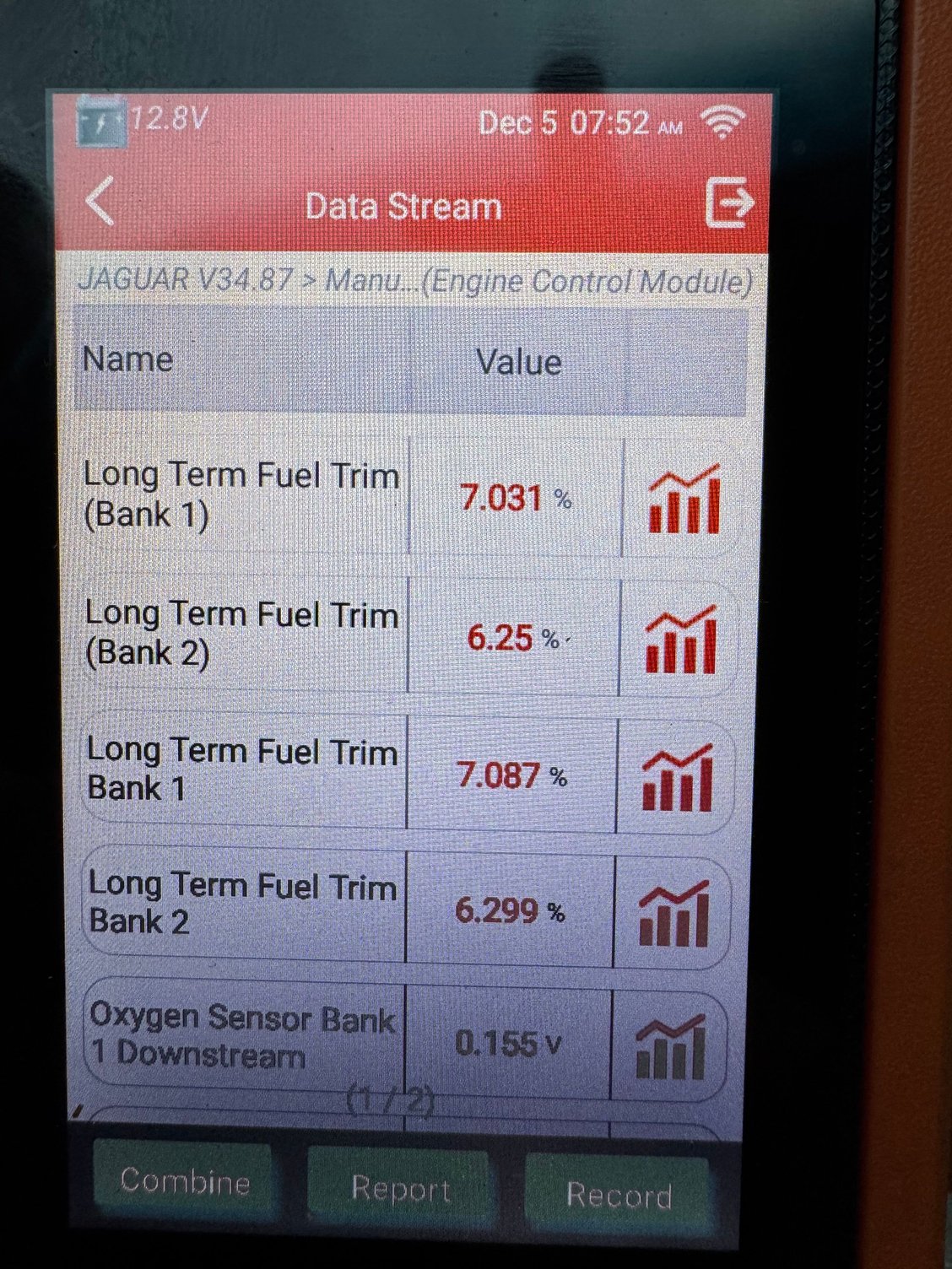

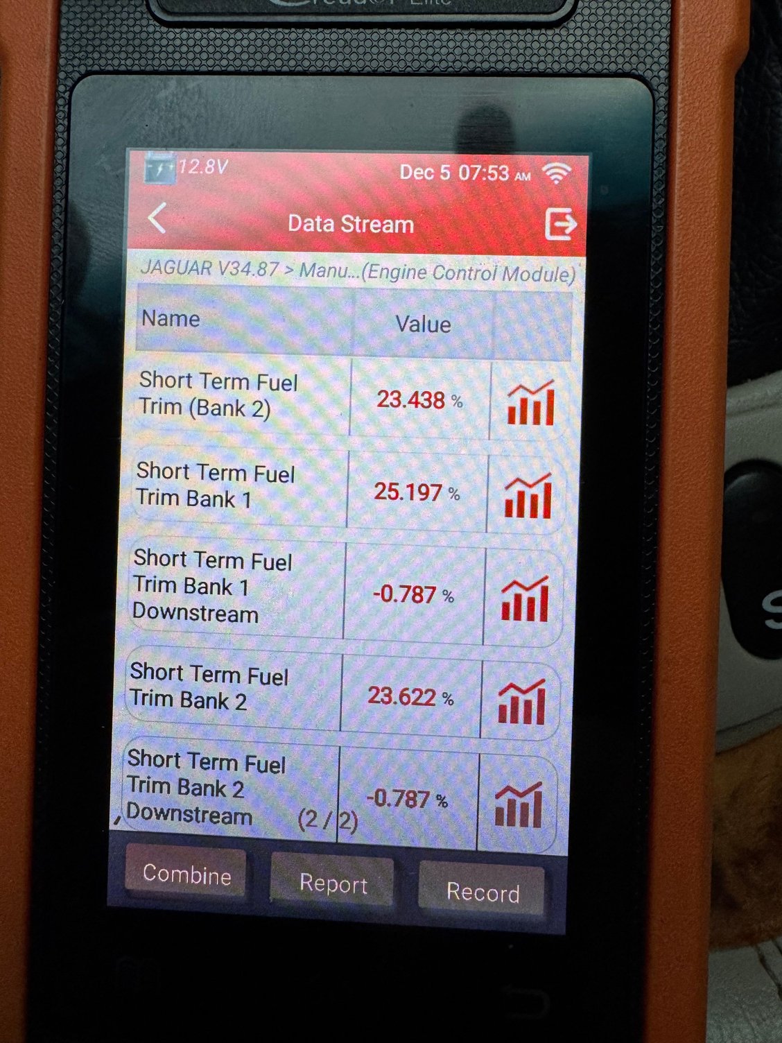

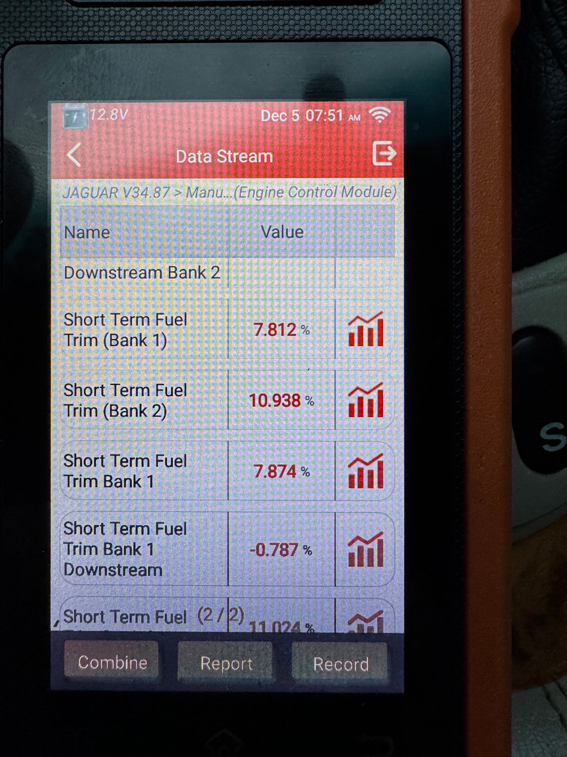

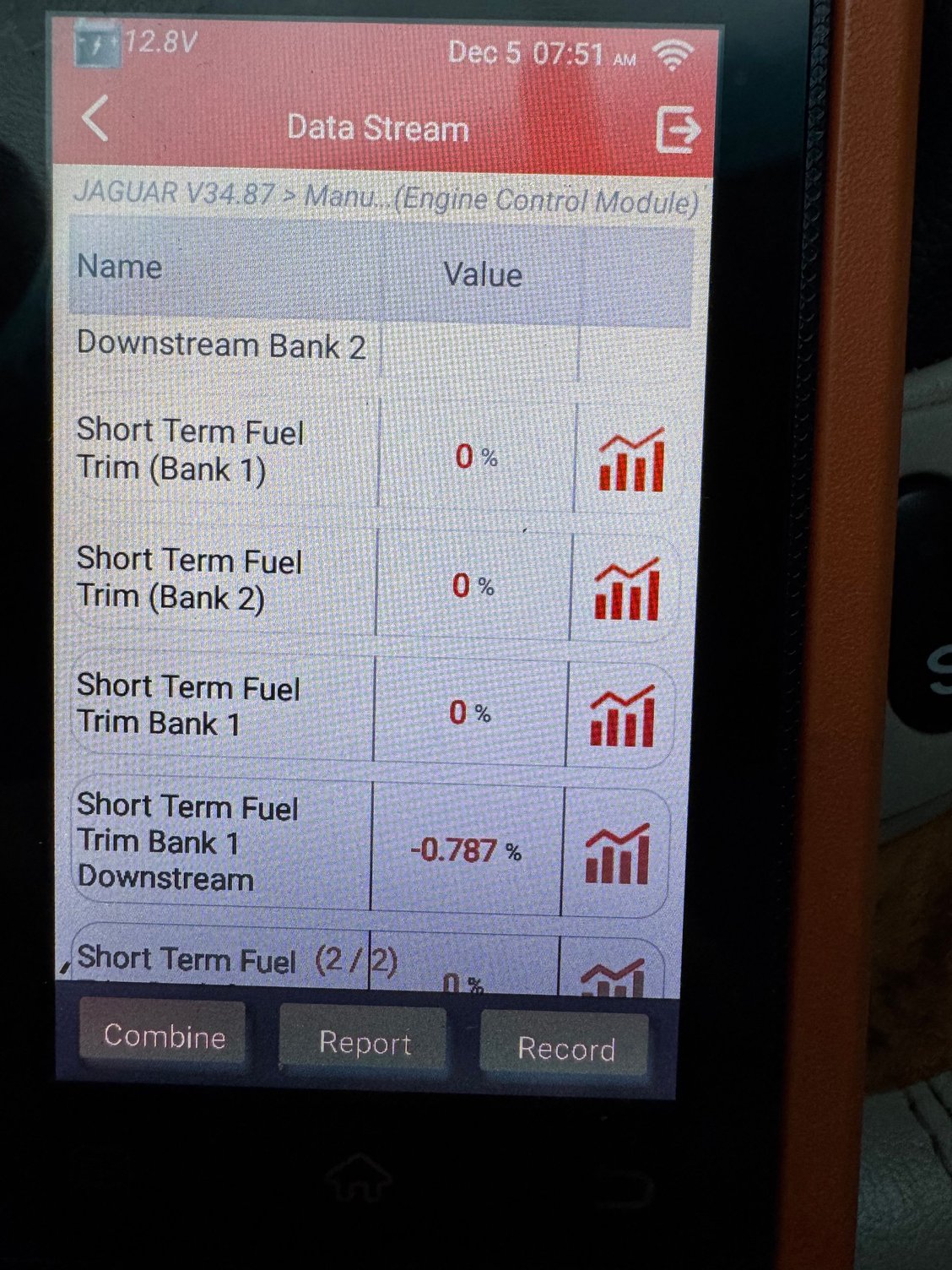

Fuel trims on cold start when the bad idle happens
n
Notice in all screenshots that the downstream short trims never change in any condition.
would this indicate bad downstream O2’s?

You may have not so reliable tester readout. It takes like 30s to get closed loop to turn on. Before that everything goes as their own weight. If I remember right short term is showing choke at the startup.

The STFTs in the last picture are extremely high on the + side; the ECM is adding a lot of fuel, which would indicate an air leak.
I've attached some good reading on fuel trims, however, this is the first time that I've seen a "downstream fuel trim." Anywhere. I think that it's reasonable to assume that the reading is from raw fuel going through the cats as the downstream O2 sensor is telling the ECM that it's too rich of a mixture coming out. IMHO

With tester that shows same pid value with totally different value can not be trusted 100%. Unless verfied with a working car. I may have looked in to the short term trim behaviour in my car when engine is cold but I can not remember how it worked.
