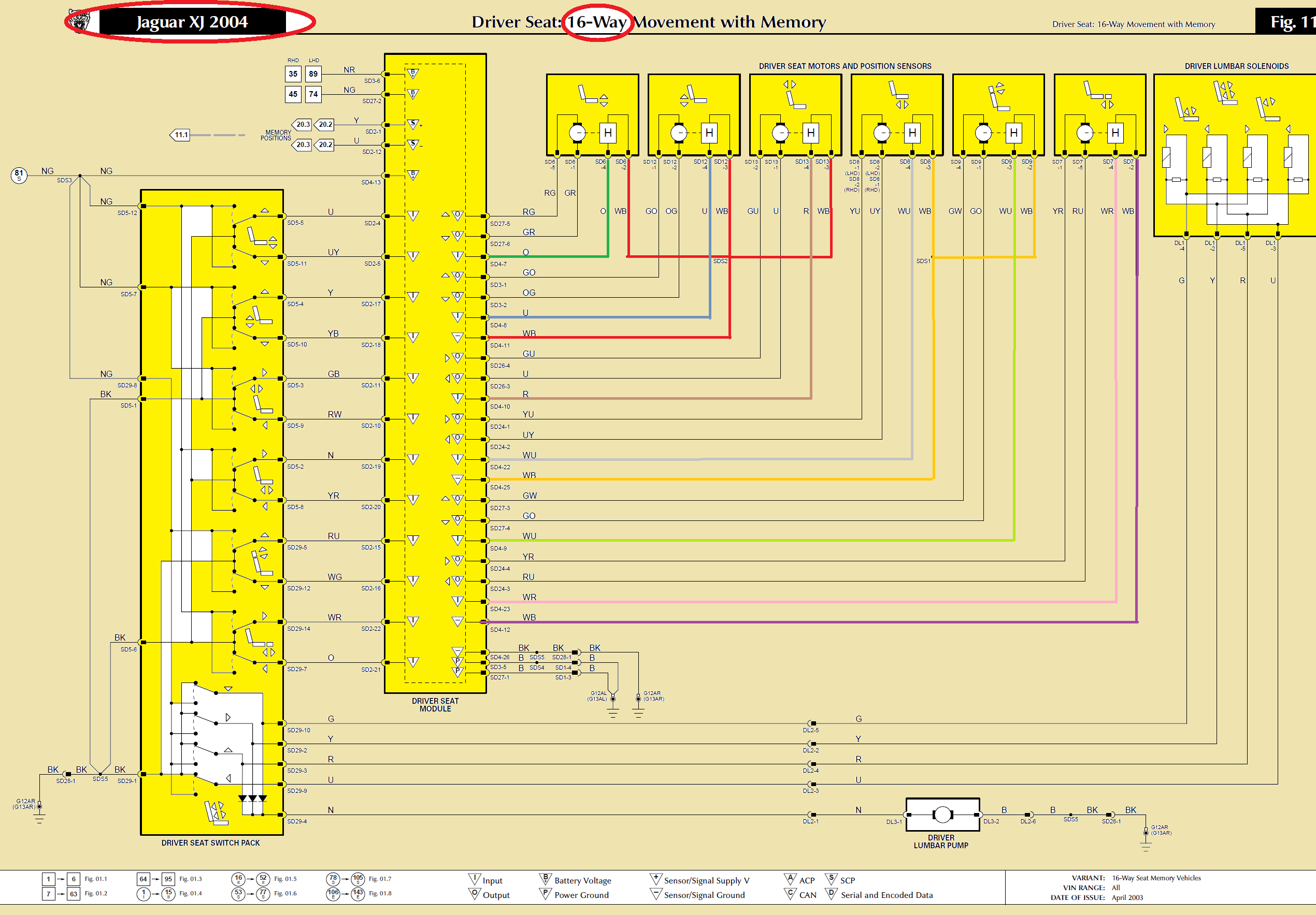

http://www.jagrepair.com/images/Elec...al%20Guide.pdf
X308 Seats are 2 wire hall effect sensors different then the X300 3 wire potentiometers , Editing
Attached Thumbnails -x308-2004-seats-untitled.png   -x308-2004-front-seat-ecu-untitled.png
