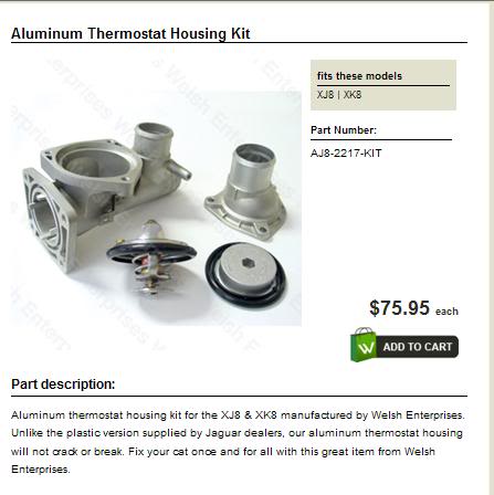

Here is a screenshot of the Thermostat Kit that manufactured by Welch:

We replaced ours 11 months ago and have had no problems since.

Jim - Now that you link to it I now remember your discussion.
The AL part is surprisingly cheap and is a must do upgrade for cars w/o SC - this is a no brainer.
........... would be interested in knowing where the thermostat comes from and where Jaguar is getting them from at this point.
