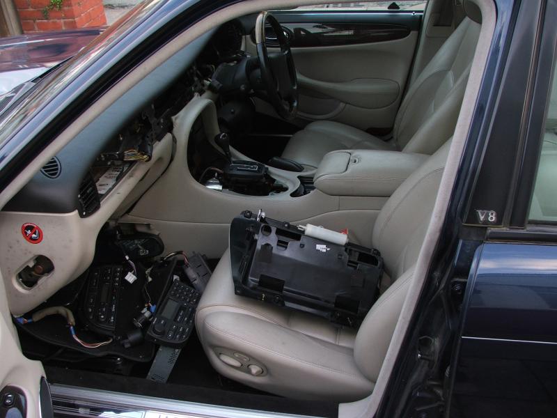

You don't like my answer, why not compare wiring diagrams, module connectors and pin locations on each module the way I did to confirm it? I've uploaded a Jaguar electrical document for you
jxj1999en.pdf
By the way 'CAN Bus is a multiplexed wiring system used to connect intelligent devices such as Electronic Control Units (ECU's) onto vehicles, allowing data to be transferred in a low-cost and reliable manner'.
If it's got modules, and they talk to each other, it's on a can bus.
If you still doubt that I have not looked into this, see the picture of a AJ26 XJR I was going to use as an electronic donor, after looking at a few modules, it was sold and I bought a 01'.....IT WILL NOT WORK ON YOUR CAR. END OF. I'm done here.
