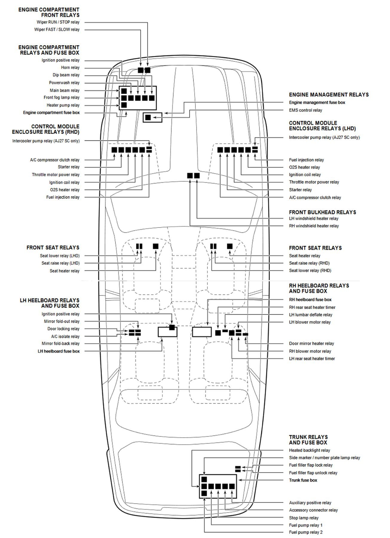

Hey,
I just realized that I Don't know where the ECM is located on my 2000 Vanden Plas. While searching, I found a panel in front of the firewall on the right side. I removed the access panel screws and found a nest of wires (all small). Some were attached to the transmission controller, and the rest went to what I imagine is another computer with warnings not to attempt to open. Am I in the wrong place? Thanks

The ECM/TCM control module enclosure does not need to be opened.
The power stud is on the front side of the fiber bulkhead surrounding that box.
You just need to unscrew on posidrive screw and lift the plastic lid to see the large positive cables and the stud.
bob
