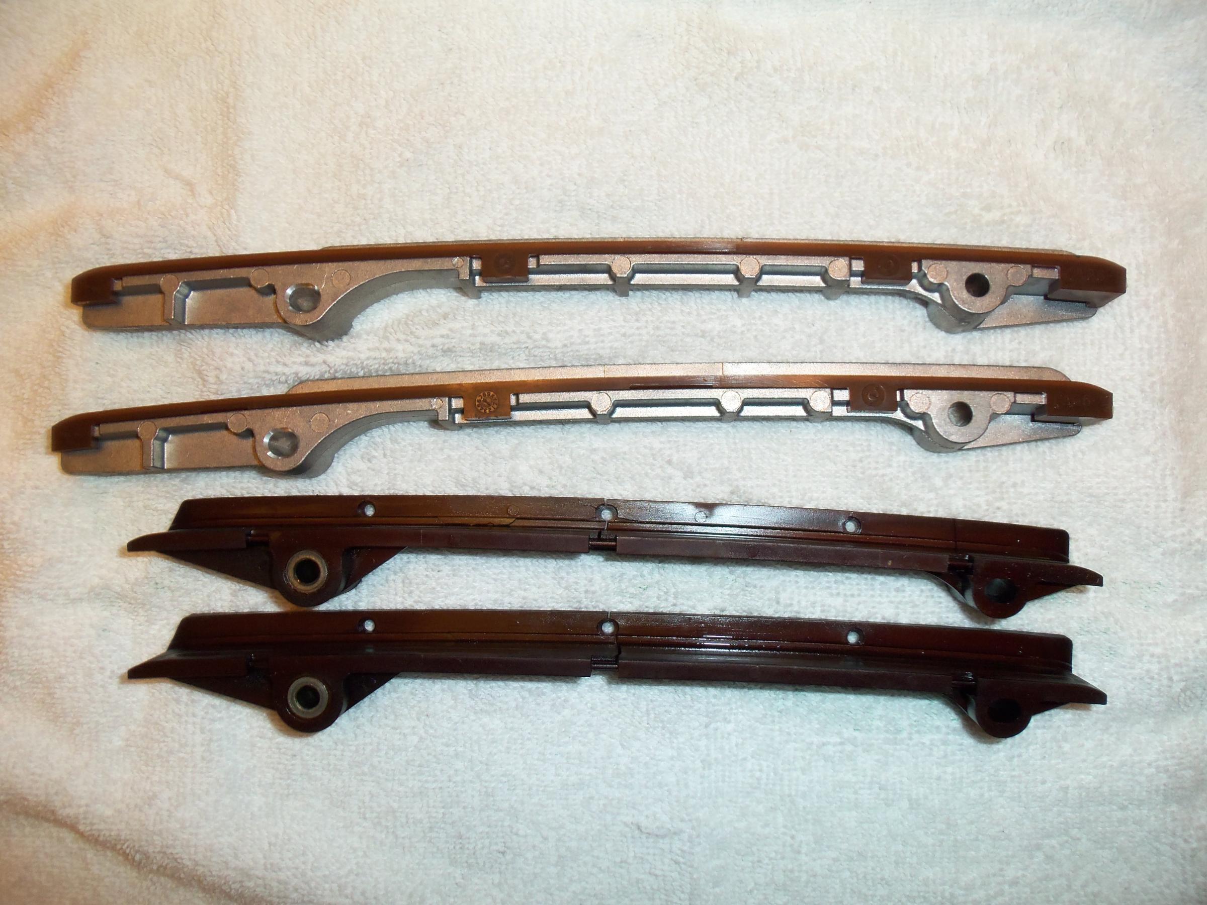

Didn't notice until re-assembly, but the new metal guides in my timing chain kit are opposite the factory ones. I need this weekend to get most of this project done on time so I'm pretty miffed, wondering if this is important or not and whether I can proceed or not.....
As you can see, the slotted hole on the factory guide is on the right (and yes, those are cracks all over my old guides....). On the new ones it's on the left. This means the one bolt holding this on, though it will be torqued down, is now in a slotted hole and not a fitted one. If you "flipped" the new guide to have the slotted hole up on the pin (or dowel if you prefer), like the factory one and as per instructions, the "back rail" is now towards the front of the car and not the back, and doesn't line up with the curved guide.
Does it matter that the torqued bolt is in the slotted hole? With the sized hole now on the pin / dowel the guide should not move. With this being totally different than what I took off I just want to be sure before I proceed. I can't believe with as many people there are who've done this, this hasn't come up before, or I haven't seen a post about it....

I know they are different, but try fitting them like my engine, here.

When I installed those in my XJ8 engine I was told they would work. It has been over a year now and they are doing fine.
