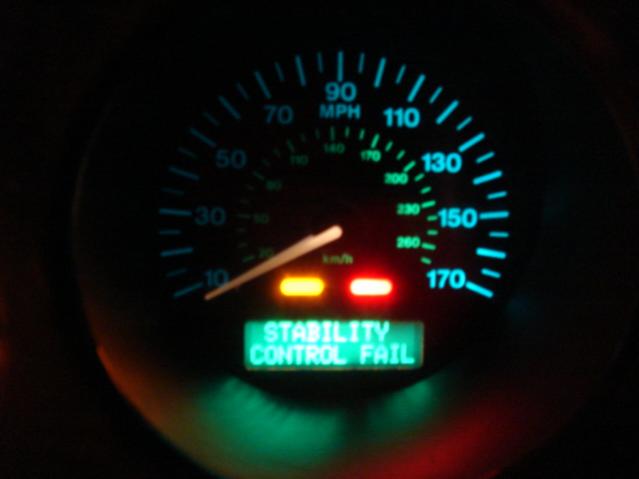

Now I have provided a picture that has these light on now what do I do to fix this problem?
importantly the amber/red light & the traction control fail / Stability control fail.
The previous owner said he cleaned the abs sensor but the light is still on dash...not sure what is the problem .he said to reset the car.
how do I go about fixing the abs sensors?? do they need to be replaced?

5ish. The Stability Fail is likely an ABS Sensor, or Wheel Bearing. I've read that either can cause this, and both are common. I would verify they are clean first, just to be sure. Beyond that, I'll leave it up to someone else to help answer as I am out of my league.

On the ABS issue: there are three levels of chronic problems. The sensor itself can get dirty enough to set a code, the cable from the sensor has been found to be so tight that it causes a CEL in turns and the ABS control module had a history of stress fracture on the circuit board. There are several posts on how to fix that.
