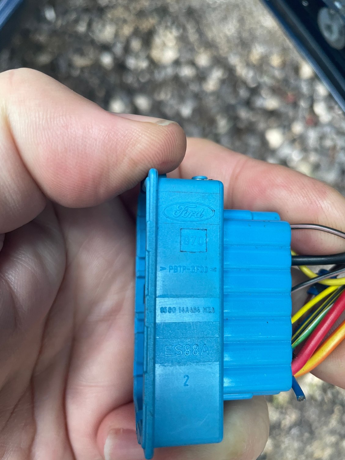

In the meantime, here's some pics.
Housing having removed the cover plate. you can see the spring connectors.
Parts numbers here but simply can't track any of them down.
Rear of the connector. You can see where the two wires have disconnected.

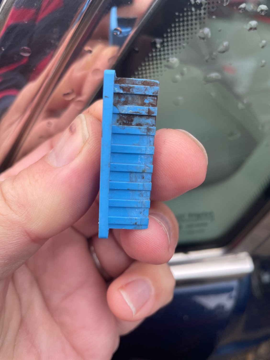

Heres the cover. You can see where there has been some sort of ingress which has presumably resulted in the failure.
