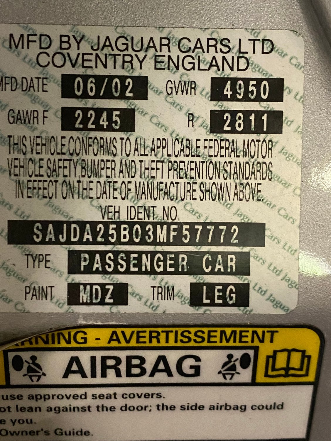

Well, it was a mid-year change for the 308 in '03...so VIN is important. Perhaps a pic would be helpful....

Here is the VIN

See page 127 and compare to page 129
X300 01/E COVER (jagrepair.com)
So you can have the CD player with or without the separate final stage power amplifier
So you need to start there in finding the amp
