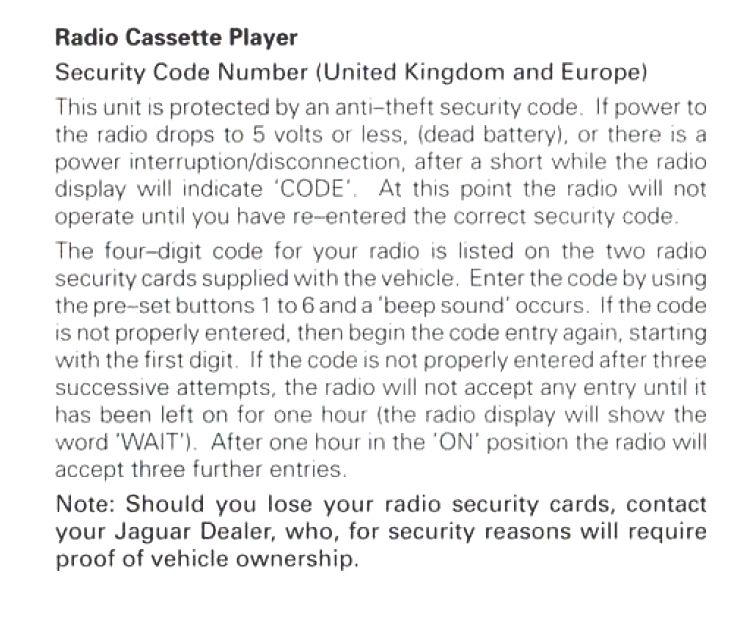

If it was working before you disconnected the battery, it's extremely unlikely it's failed.
Note the warning in the Audio Handbook about entering an incorrect code.
After three attempts, the radio must be left powered ON for an hour before you can try again.
