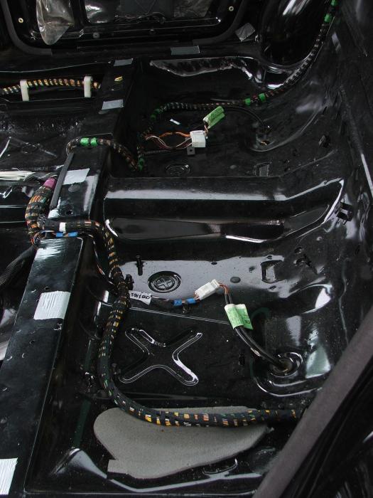

Ok, so now I am going to go back and fixt the wire I broke going to the right rear shock. Before I do that, does anybody have the part number for the wire? Also, does anybody know where the back end, the end not attached to the shock is connected?

John - they're connected to the rear harness on both sides in the rear seat wells. If you lift up the seat you'll see a connection going through the floorpan, and a sealed rubber grommet going to the shock end.
The picture shows the two link leads connecting to the rear harness.
Part number is LNF 3425BB
It includes both ABS wheel speed sensor link lead and CATS lead, if you stretched one, maybe the other too.....
