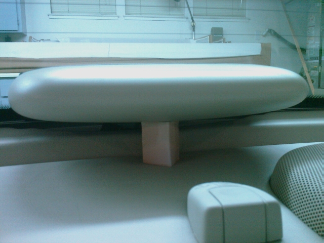

Smile And the award for creativity goes to.....
Step 1. Find a shoe box or anything that is made of stiff cardboard. (and preferably glossy cardboard the same colour as the car interior)
Step 2. Cut a piece out, bend it into a "V" shape and wedge underneath the offending falling off rear brake light
Step 3. Marvel at your creativity :-)

Default cretivity still rattles when you hit a bump
Well
the cardboard post (or wood thatI use) does hold the light in an upright position. But, when I hit a bump, it gets loose quick and the rattle drives me crazy. If the weather in NJ ever gets better, Ill glue the light
