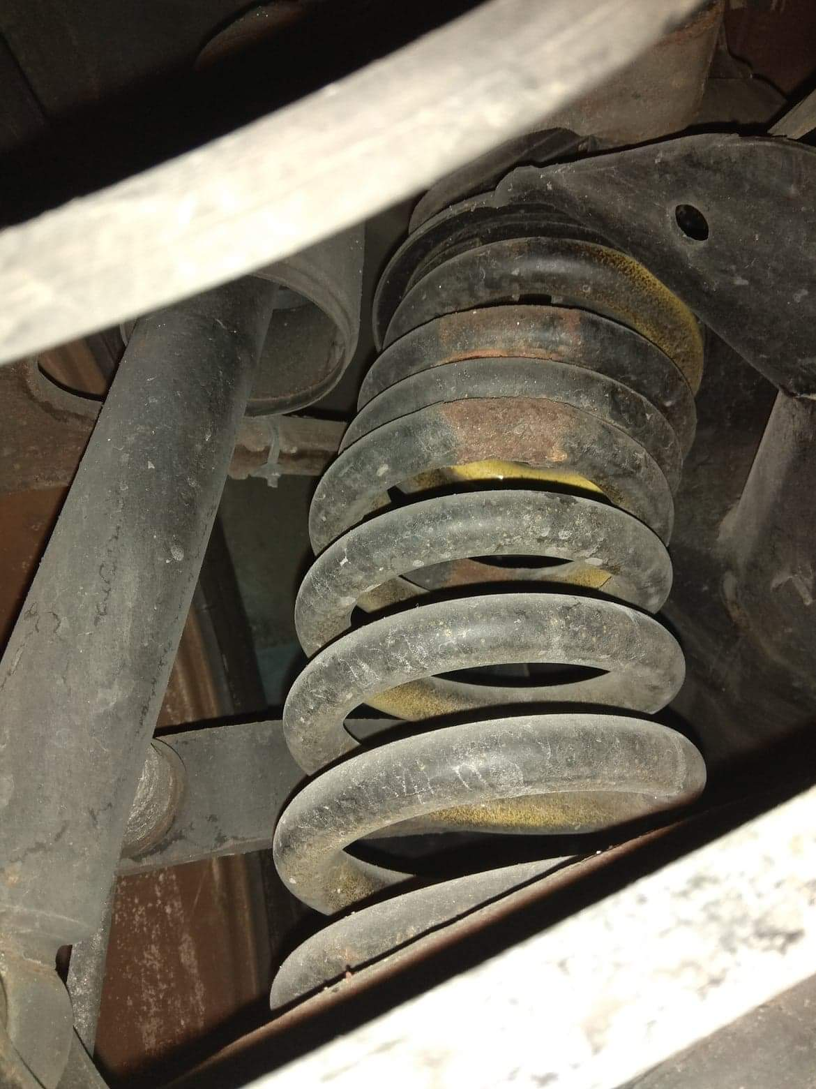

I received some pics of the underside just now, seems they indeed only changed out the springs (yellow, no brand determined yet).
I was contemplating to use them on my car, but decided against it.
It will be the end of practical use of my car, will not be able to drive it out of my B2 parking without getting beached.

Judging from the photos and the angle of the springs along with the rust spots localized in one general area, i would say these springs have been “lowered” via torch. Block the car to the desired ride height and heat the springs up until they collapse onto the blocks. Extremely bad way to lower a vehicle.
