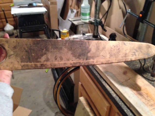

After stripping with heat gun:

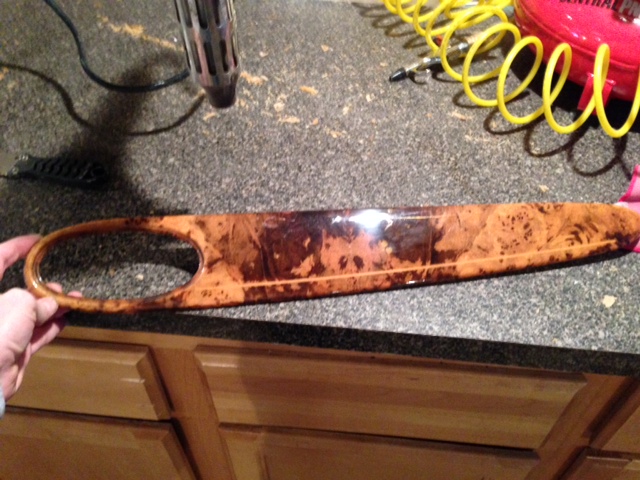

After applying a stain:
After applying first coat of poly. Brought out the wood nicely, but obviously more coats needed to get that glass look:
I'm going to use 6 coats of helmsman high gloss poly to thicken it up and allow for wetsanding and waxing. Two more coats to go. Most annoying part has been waiting for dry times.

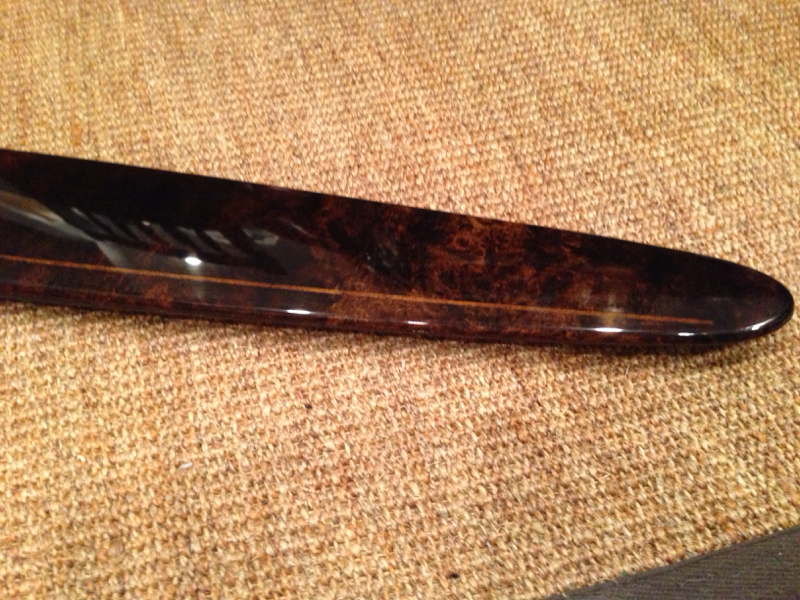

I'm getting readt to put a 5th coat on. Here's what it's looking like after 4:
Seeing my reflection in this one:

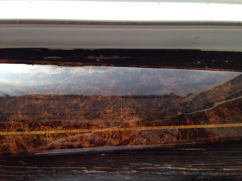

Finished the poly coats. 6 coats. Here's some pics before wet sanding and buffing. The wet sanding should remove any "waves."
The knob was originally a very light oak color. Good thing about the knob is it's wood is thicker than the veneer panels. I would strip this first for practice before the veneers.

Here's after wet sanding:
Here's after buffing:
Here were my steps if anyone is interested:
1. Stripped old finish with heat gun
2. Lightly sanded with 220 grit
3. Applied miniwax dark walnut oil based stain (. Original trim came out of a car with lighter interior. It didn't match my sdz trim the same way)
4. Applied 6 coats of miniwax helmsman clear gloss polyurethane
5. Wet sanded with 1000, 1500, and 2000 grit
6. Applied meguiars swirl remover and ultimate compound.
7. Applied and buffed with meguiars cleaner wax
