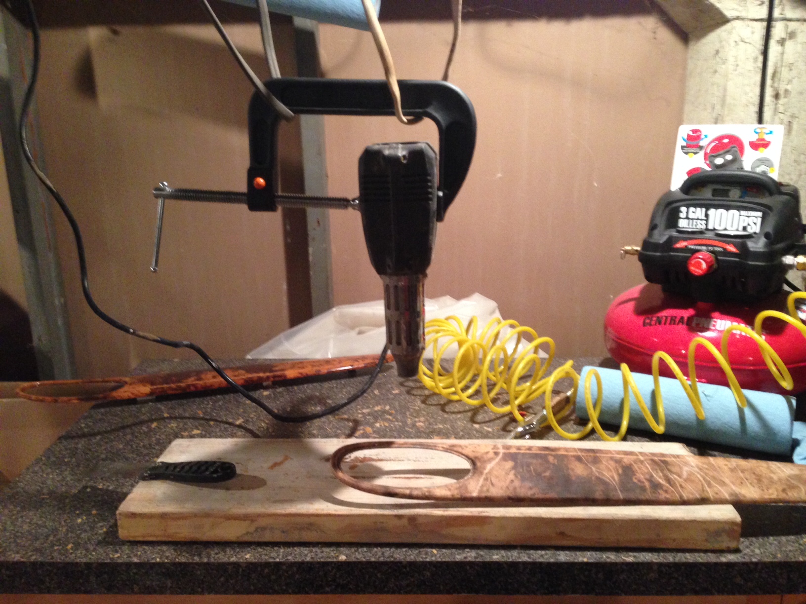

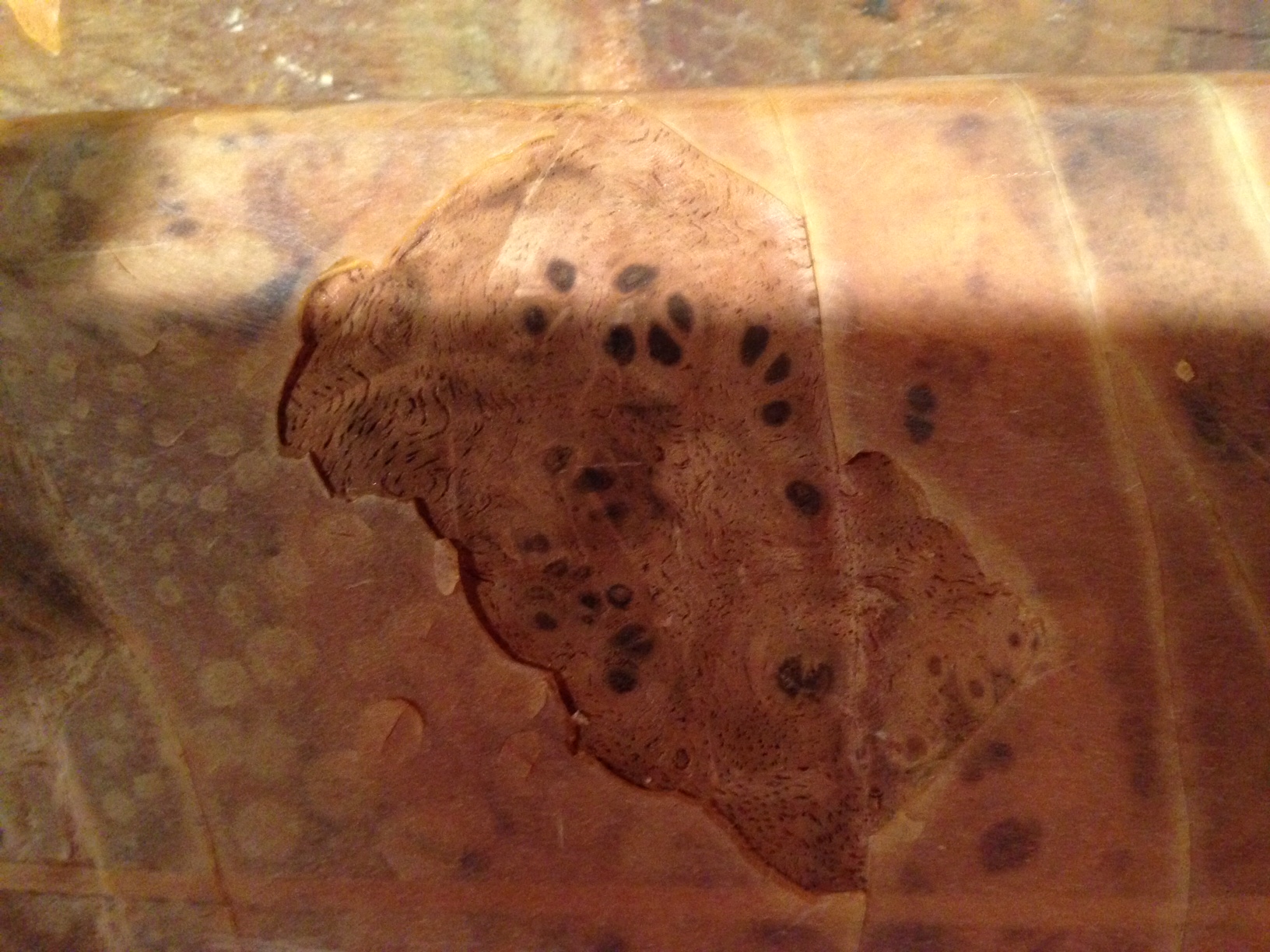

I'm taking some spare wood trims and redoing the finish (98 Vanden Plas). I'm pretty sure they are coated with polyethylene terephthalate (PET). Regular Strippers won't do anything to this substance. It's the same stuff they use to make plastic soda bottles.
I set up a little heat gun station in my basement. I hung the heat gun, in order to make it easier. Otherwise I'd need three hands. It took me 15 minutes to remove the Polyester off one wood trim piece. I didn't burn any spots, which was my only worry. Once I had all the PET off, I noticed the cracks were still in the wood. I don't think the wood is cracked, but the shade around the cracks lightened with age and sun light.
I would've tried to sand the cracks away, but the veneer is super thin. I'm going to put a stain on it since the natural wood color is too light for my XJ8 interior anyway. I'm then going to coat it with MINIWAX Helmsman 350 Gloss. That Urethane should be good with sun and temperature changes. I figured I'd try it since the original stuff cracks anyway. I'll let you know how it turns out if anyone is interested.
The only other finishes I would consider using are Nitro or the original PET formula. Nitro is very tough to deal with and I already know what PET does. Guitars use both of these finishes. If you didn't wan't to try and do it yourself and want to avoid high costs, I would check guitar shops and see where they send their guitars to get refinished. May get a good deal. I like to DIY as much as I can, so I'm going to keep on it. If these turn out well, then I'll use them as temporary replacements while i work on the wood trims currently in my XJ8. I don't plan on staining those.
Here are a couple pics I took so far. If I can get a spare hand, I'll record some of the removal:
If anyone has found some better techniques, please let me know.

Also, When I'm done with the miniwax poly I'm going to buff/rub it out. I plan to wet sand the finish followed by applying car compound and polish.

so far so good. I have them stripped and stained (I did a Dark Walnut). Helmsman poly next. I'll post pics of process when I get a chance.
