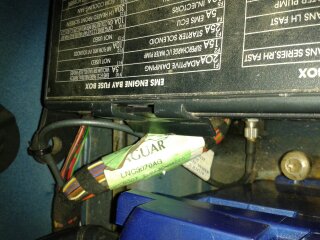

Just been out to the car and took a photo, Black wire that comes down behind the loom,( green label JAGUAR ) goes down and terminates in a chrome fitting under the fuse box.

Sorry, missed a bit of text. The blue at the bottom of photo is the battery, so this is looking between the rear of the battery and the front of the fuse box.

Andrew: Thanks so much for taking the photos. I have been able to identify the module. All wires seem to be in ok condition. When I try to learn new remotes, I even hear the chirp (only once). But as I press the buttons, nothing happens. Checked batteries twice, got 2 remotes, both 433 Mhz, module is also 433 Mhz. Is there any other test I could do to be 100% sure its the module?

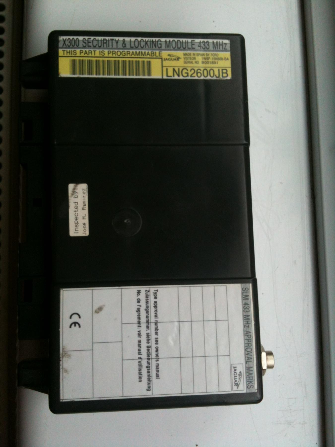

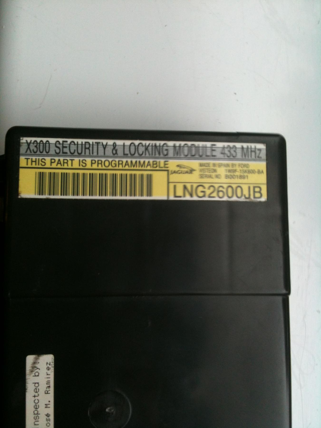

These are pics of the SLM, situated under the fuse box in the trunk. I would certainly make sure that the remotes are actually working before going to the expense of replacing the SLM module. I don't recognise the "Green Box" part number at all.
The tester I bought is sold by Sealy Professional Tools, and is called an IR & RF Key Fob Tester. Model No VS921. Web page WWW.Sealy.co.uk Bill W.

Hi, Yes, the "Green Box" is the same one as I came up with, and fits an 'S' Type Jaguar. As you have an XJR this box is no use. If the remotes definitely work, then as far as I am aware then the SLM may be faulty. First I would make sure that all the cables that attach to the SLM are fully seated. All you need to do is to remove the 4 bolts that hold the rear fuse box and lift it up out of the way. The SCM has 2 multi cables plugged into it, plus an aerial that screws into the opposite side to the plugs. It is this aerial that the remotes use to contact the SCM to tell it to unlock the doors. As a last resort I would disconnect the aerial and the plugs, take out the SCM and open it up, there are plastic clips around the edge that can be sprung apart to release the base. You will then see the PCB. This lifts out along with the sockets for the cable. Be careful not to lift the PCB out too far as there is a smaller PCB attached to the base that the aerial connects to. Carefully inspect the PCB's for any obvious signs of damage. Bill W.
