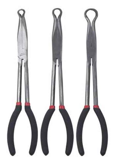

I just push the release tool up HARD with some long pliers, ringed at the end.

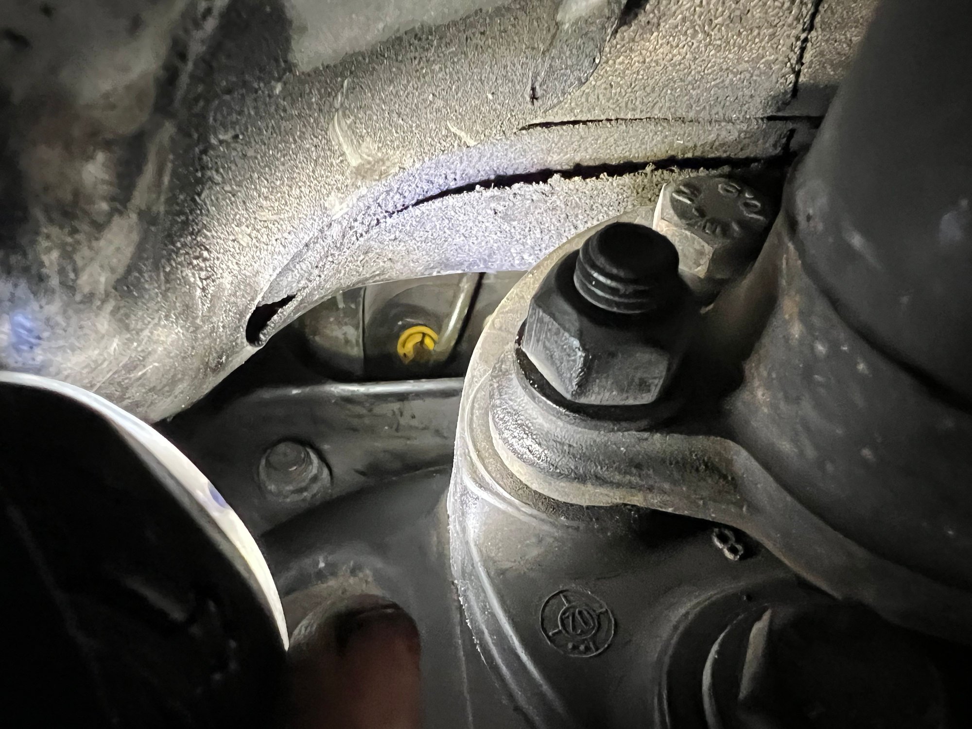

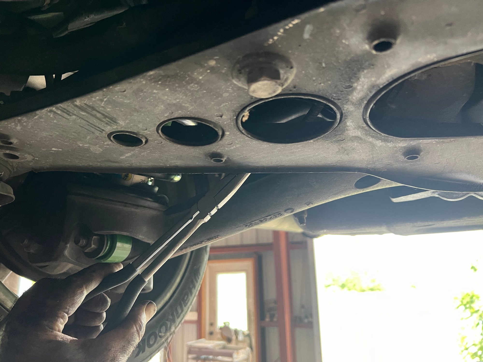

Still working on it. Wish video showing. Only ones I’ve found pull tank without disconnecting.
Do you go in by the fourth or fifth picture or another way?

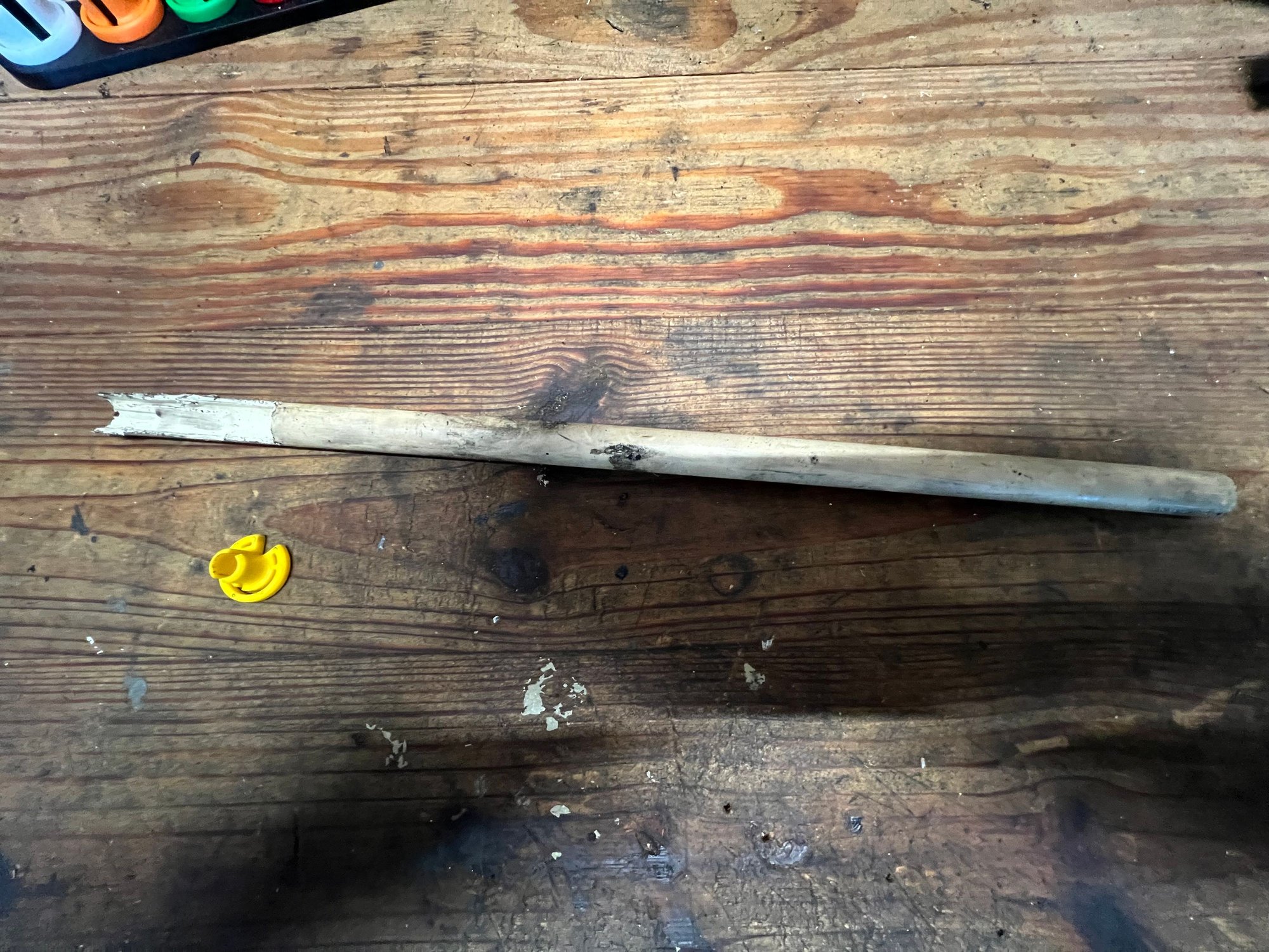

Started with a length of PVC with a channel cut on one end

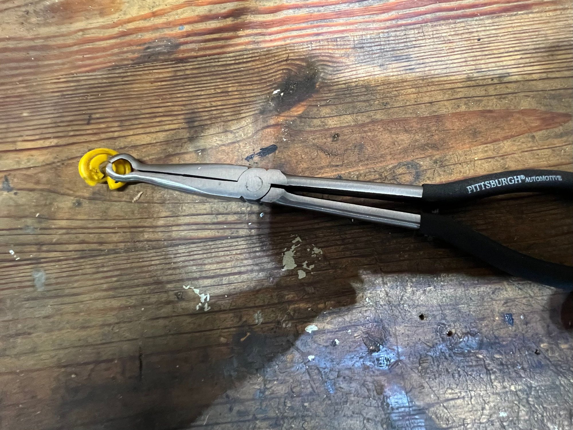

Switched to this per @motorcarman

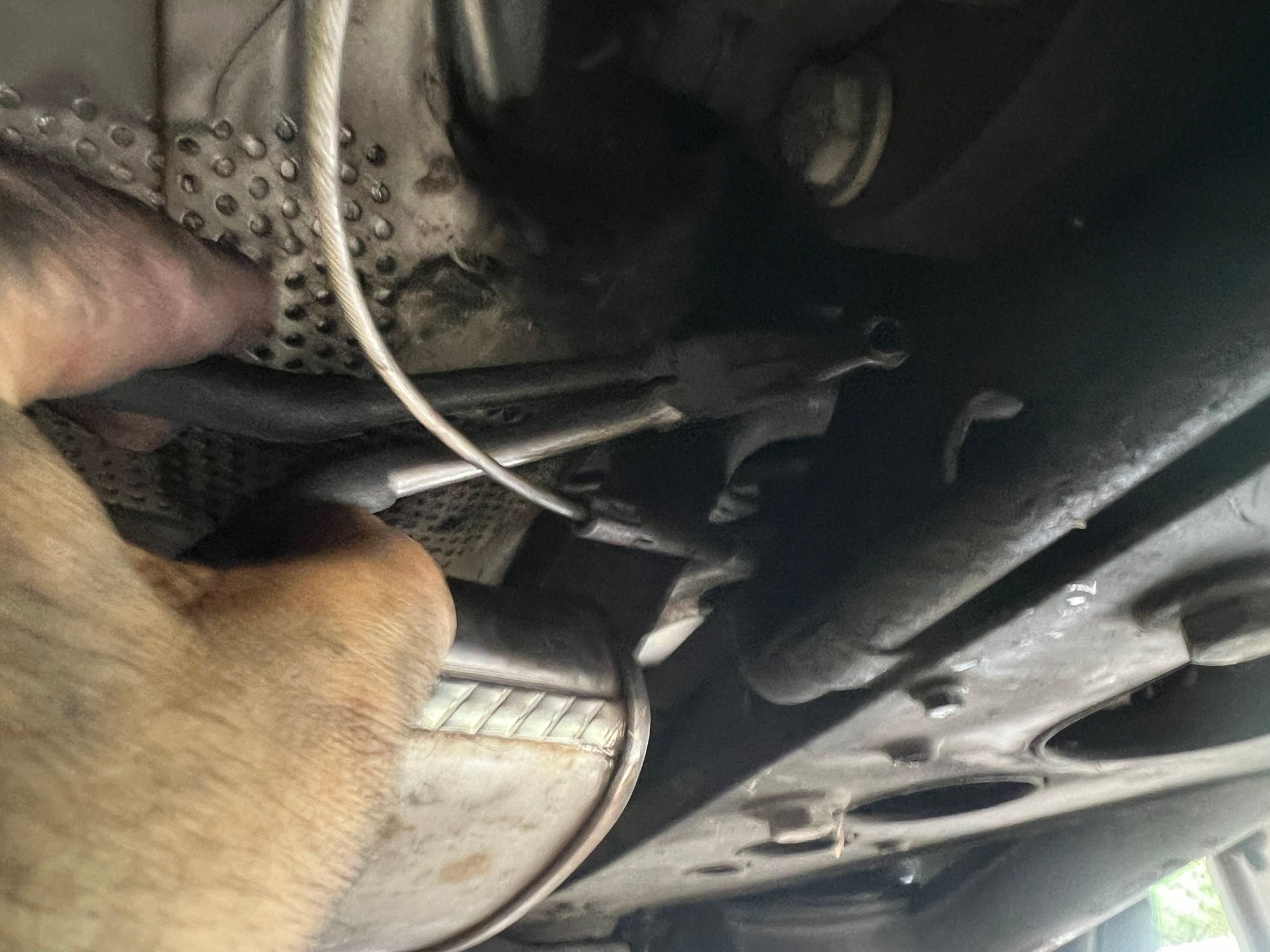

Disconnect on
Disconnect on return line

Return released.
Half way there.

Done. Now that have done once, could do again in a third of the time. Used a combination of different length flat head screwdrivers to push in disconnet. Hint: tie a string to the disconnect so you don’t lose it.
