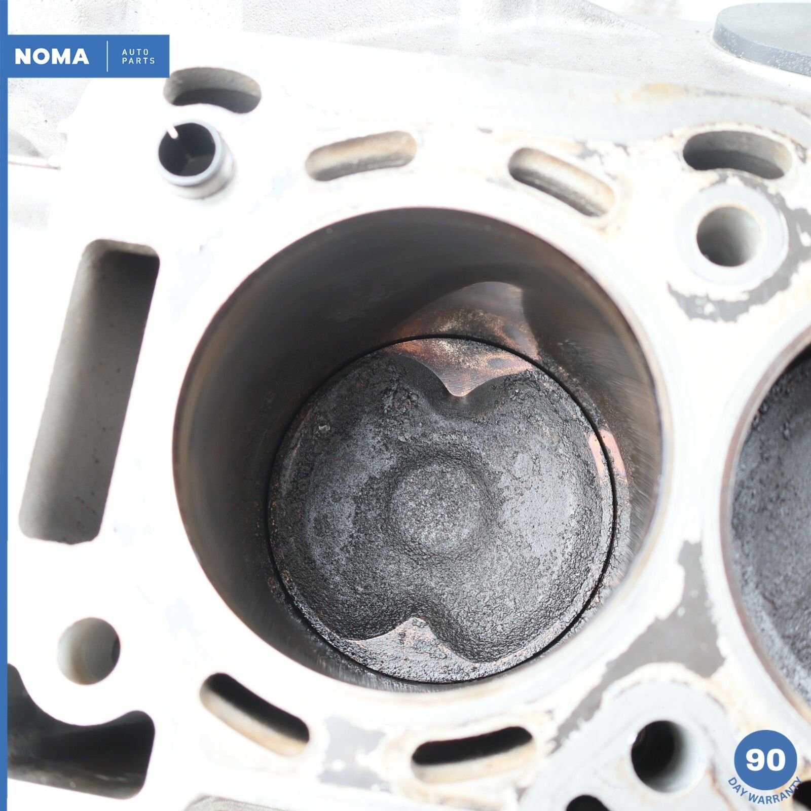

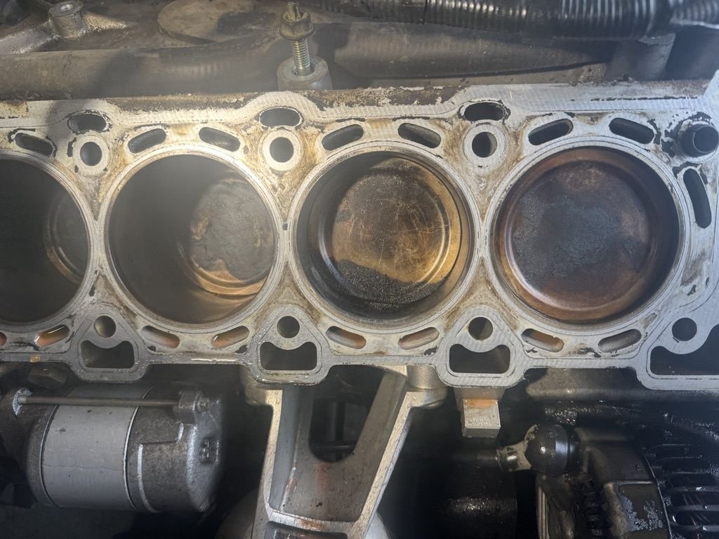

Hey everyone,
I'm trying to find replacement pistons for my engine block rebuild and wanted to get some guidance. At the moment, I have a new block with a set off pistons from a 2005 XKR. The original 2002 XJR 4.0L Piston is visually different from the 4.2L Piston in the 2005 Jaguar XKR
Currently, I've got the block sent off to the machine shop to be completely re-done and feel like this is a good time to replace the pistons as well due to mileage and age. Modern replacement information seems to be pretty scarce. While I've been able to track down the part numbers, sourcing new Pistons and Rods have been pretty problematic.
Are there any new potential replacements any longer?
2002 Jaguar XJR Style Piston:
2005 Jaguar XKR Style Piston (AJ811213):
