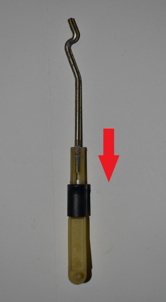

my problem is removing the bar from the tumbler and the handle so that i can slip it around the inner workings and out...96 xjr.....how does that come apart...it looks like its locked into the stuff...pics would be helpful or a walkthru....thank you for any help...
Old Apr 3, 2014 | 04:10 AM
Although I haven't done a latch on an X308, from the Parts Catalogue it looks very similar to the XK8.
The link you are unable to remove is possibly this one?
If so, it comes apart by sliding the black collar down ......
...... and popping the metal rod out of the plastic sleeve
The rod stays on the handle and the plastic sleeve stays connected to the Latch.
