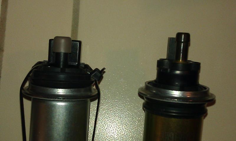

So, I decided to give up on the Densos as I really don't like the way that they fit. The female connector is much larger than the one on the OEM pump which causes the top rubber isolator to not fit properly in the bracket. I had to put a tie-down strap around the pump/bracket to keep the pump in place. That may hold up, but with all of the work involved, i want this to be perfect before putting the tank back in there. Plus the wiring issue still has me concerened.
I would post the pictures that I promised, but I need some lessons on how to insert images. When I click the icon, it wants a URL, and I have no idea what mine is or where to find it.
Attached Thumbnails Replacing fuel pump on 2002 XJR-imag0043.jpg   Replacing fuel pump on 2002 XJR-imag0044.jpg

Here's one more picture of the top of the Denso pump. You can see that the top isolator sits further down on the OEM pump. The two isolators compress in the bracket holding the pump in. With the Denso, the isolator will not fit in the hole, therefore, the strap to hold it in.

What do the isolators look like?(NM, figured it out looking at the pictures more)
And what gauge wiring is used in the link wires?
A larger connector is not in and of itself a bad thing. In addition to the effects of the "black box", pictures of the wiring suggest that is undersized in comparison to what is accepted as being adequate for 10 amps. Do not forget that for the primary pump, while not always at max, will be at least present at all times that the engine is running.
The JTIS troubleshooting section says: "current between 2.5 and 9 A" for the pump current draw test as a pass.
