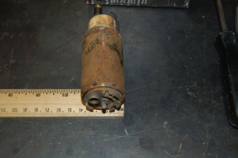

plums - I took a bunch of pictures with the ruler next to the brackett; hopefully they're useful
Yes, thank you very much.

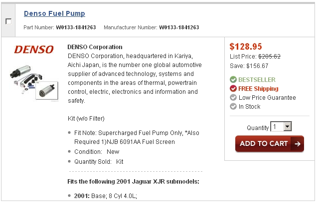

Thumbs up exact Denso match found
see how the following listing calls out the SC motor:
(edit - other sites will also show other applications, oh well)
Denso Fuel Pump
$106 at JCWHITNEY
The Airtex E2471 is also listed for up to 2003 depending on the site.

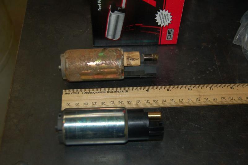

Here are some pics of an original 1998 XJ8 pump and a NEW Airtex E2471 pump.
I had to trim the original upper and lower rubber retainers with a razor and scissors to get the proper fit. The electrical connector on the Airtex is a little larger and the bottom fuel pick-up area has some different casting patterns.
bob gauff
Attached Thumbnails Replacing fuel pump on 2002 XJR-xj-fuel-pump1.jpg   Replacing fuel pump on 2002 XJR-xj-fuel-pump2.jpg   Replacing fuel pump on 2002 XJR-xj-fuel-pump3.jpg   Replacing fuel pump on 2002 XJR-xj-fuel-pump4.jpg

That's a lot of corrosion on the old pump. My old ones came out really clean with no corrosion. Is there any way to get a hold of a couple of those leads that come with the Airtex? I think that I'm going to hold on to theses Denso pumps for next time, and those leads appear to fit.

Yep, that's the site and pumps that I ordered. But, when talking to Denso, they say that the part number (951-0008) does not come up for a 2002 XJR.
The screenshot is "allegedly" not of a 951-0008 but instead W0133-1841263. So you may want to rethink keeping the pumps. Anyways, "next time" is hopefully a long time away.
The information is not verified by Denso, and the differences are unknown, but applications go like this:
PHP Code:
DENSO FUEL PUMP LISTINGS (UNVERIFIED)
1998-2003   W0133-1841263   (kit)
1995-1998   951-0008        (generic kit)
1995-1998   950-0183        (factory fit kit, includes fuel pump screen)
The reason the pump is corroded is because the car had a faulty alternator and it sat for a year. The fuel filler area 'scupper' had leaves and debris in the drain hole so water filled the area. The fuel cap seal was bad so the water flooded the tank and corroded the pump. If the customer had the alternator problem resolved earlier, then the car might have been running all this time!!
I have another XJ8 in the shop now for an inop fuel pump. The cooling system was leaking from the thermostat housing so the car was parked for a year. The fuel filler area 'scupper' drain was clogged so a faulty cap allowed water into the tank and now the tank is RUSTED along with the pump and retainer bracket. Unfortunately this tank is not useable so a good used tank is needed.
My advise is to CLEAN THE DRAIN IN THE FUEL FILLER SCUPPER.

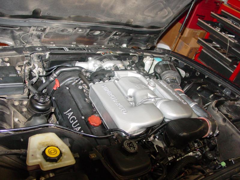

plums - I've done it before. When I did my timing chains, I also had the SC rebuilt, and it came back painted 'hammered silver.' Well, that didn't match the intercoolers and the SC top, so I bead blasted those pieces and painted them the same coloor as the SC. While I was there, I did the cross-over pipe and thermostat housing, so all of those pieces are hammered silver. Started it up, and grabbed a cold one. Oh wait, the thermostat housing had a leak; darnitol! Took off the housing and it had a little bit of paint, so cleaned it and put it back on. 20 minutes while holding the beer ! Well, I might have had to put it down once or twice, but not out of reach !!
Here's a few pics ...
Attached Thumbnails Replacing fuel pump on 2002 XJR-dsc01605.jpg   Replacing fuel pump on 2002 XJR-dsc01612.jpg   Replacing fuel pump on 2002 XJR-dsc01614.jpg
