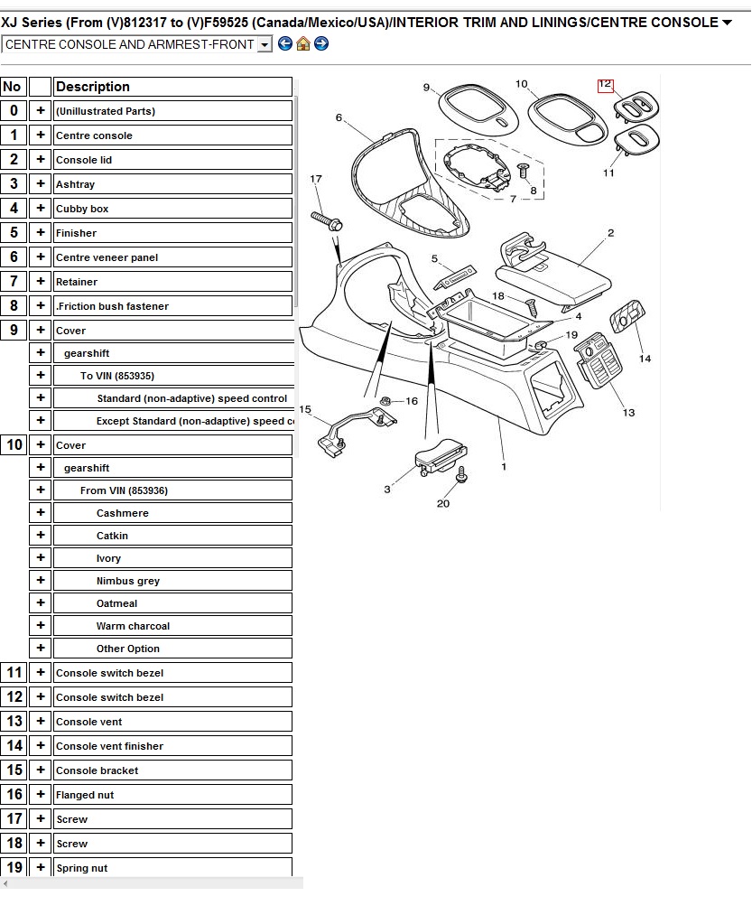

The Cover (item 9 or 10)?
Trim parts are generally the first to disappear from Jaguar inventory. If it is still available, prepare yourself for a similar $$ shock like the wheel emblem.
Sourcing used parts is the way to go with items like this. Note the different types depending on VIN and adaptive speed control.

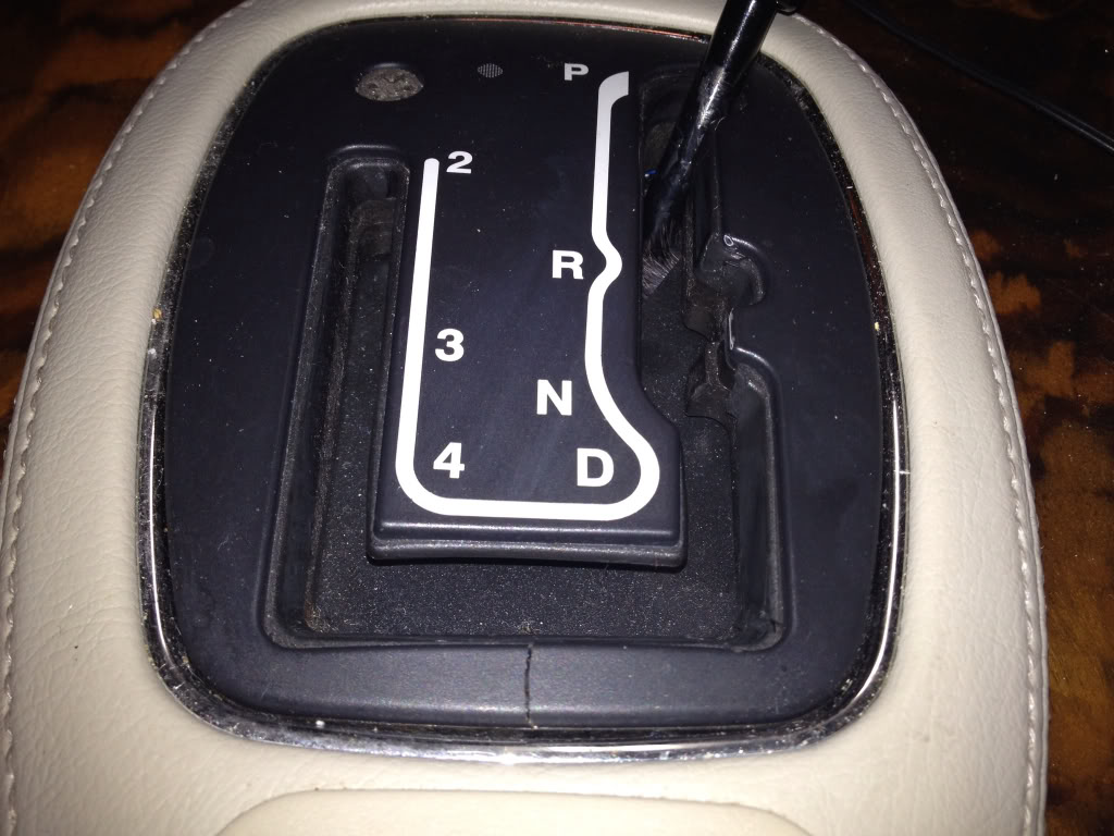

Which piece of plastic are you talking about? If you look at this photo, you'll see where mine is cracked. I've seen a number of XJs with this same "flaw," so I wonder if it's just a weak link.

The part you need is the part in this photo that has the lettering on it: (this is from post #9)

That's interesting. My J-gate surround was cracked like that too. I guess from the PO slamming the shifter down into Drive. I replaced it with one off FleaBay.

Mine has the same crack. I tried gluing it from the bottom end to not discolor the plastic but it snapped again a few days later. I have not decided if I want to replace it or just leave it as this seems to be a problem everyone has.

One of two things causes this.
As has already been mentioned...slamming the shifter down into 'D'
or, it can also be caused by very rough handling when removing the trim piexe to replace globes or whatever.
These are alway available from various Jaguar breakers and places like E-bay.

Part number is LJA6195BG GEAR SELECTOR ILLUMINATION MODULE
Jaguar Classic Parts UK > Part no. LJA6195BG - Gear selector illumination module parts
This is part 3 on the illustration - click on image when webpage opens to get larger view of illustration and part number list:
https://www.dropbox.com/s/gl8ns8ie77...n%20Module.jpg
XJ Series from (V)812317 to (V)F59525 (X308) Gear Change Control-Automatic parts
