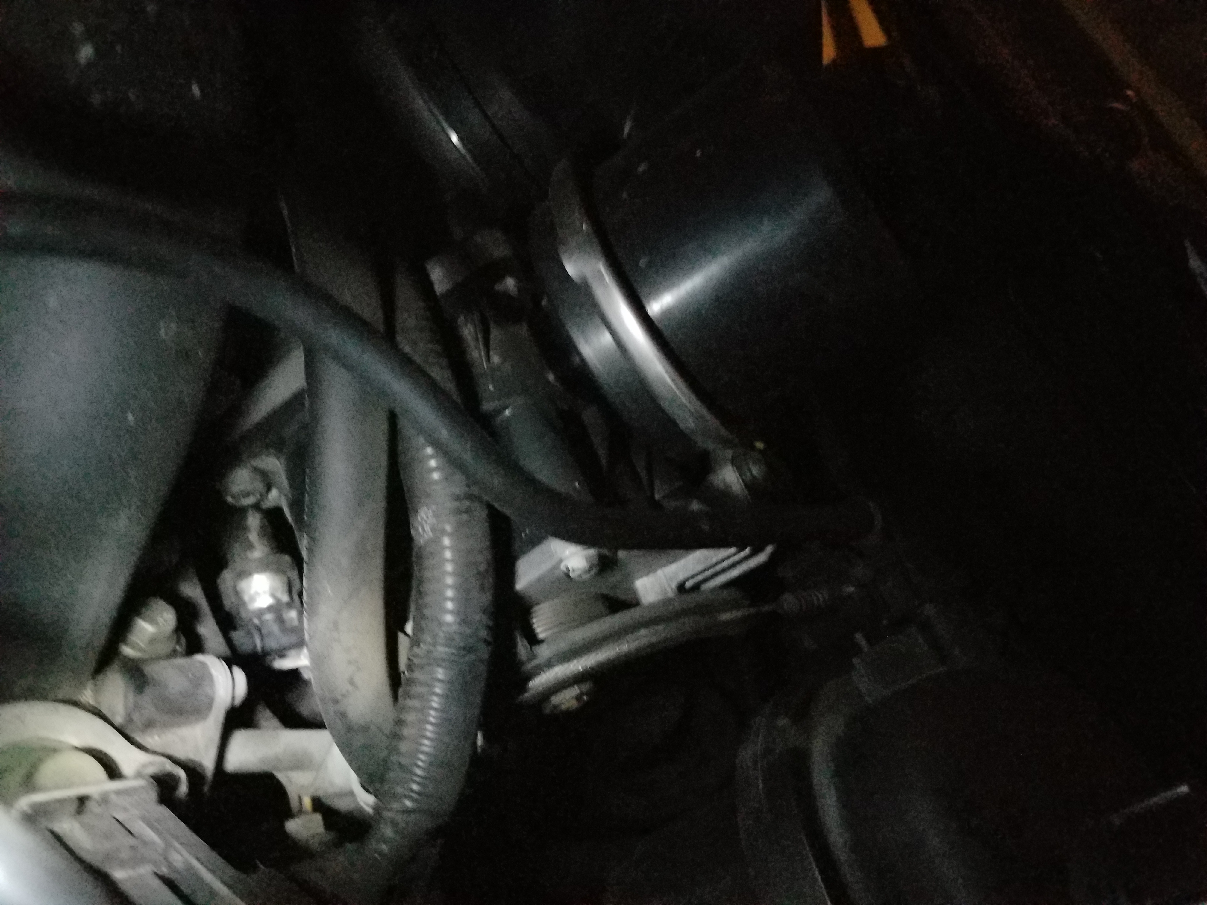

You answered in your other thread. No problem. Did you find it? This could be your restricted performance problem.

Haven't found it yet. Getting very frustrated!11

Don't get frustrated. I found a flashlight with a weak battery.
1st pic- comming out of cam cover.
2nd- under intake in valley. Yous may not be in the exact same place.
3rd pic- close up of it at the base of the throttle body. Its a T connection and the other end attaches to something else. It's attached to silver nipple.
4th pic- wider view showing the throttle body

I do have the outer part in pic one. The piece that looks ribbed and black plastic nothing sticking out though will have to check. I also have the one running in the valley by the knock sensor. Soon as I get the part number I'll get it on order. I greatly appreciate the pic and all the help from the forum. I used to pay to have all work done on my baby times have changed and I must say I enjoy it but it's a long way from the small block chevys I cut my teeth on.

On other thread I gave a link to SnG Barrett. They have one of the better prices on this. About $28.
