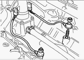

The sensor is about $120.00 +/- a few. First check if one of the wires are not chafing against the frame or a bolt causing it to give you a false reading.

From: TEXAS
I think you guys should know I just ordered another knock sensor (airtex part number 5s5619) for $36 shipped new. Of course, once it gets here I will know 100% that its the right one, but it think it will be teh win.

From: TEXAS
OK I got the new Airtex sensor today and the wires were like 6 inches or so longer than the original sensor, but they tucked away nicely. No more restricted performance for me! I think the application for the knock sensor is for a 99 xk8. Thanks for all your replies.
