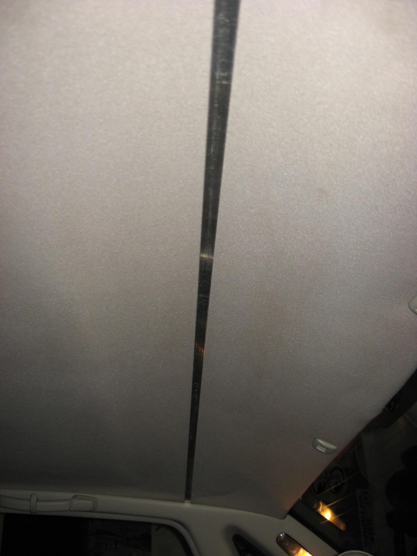

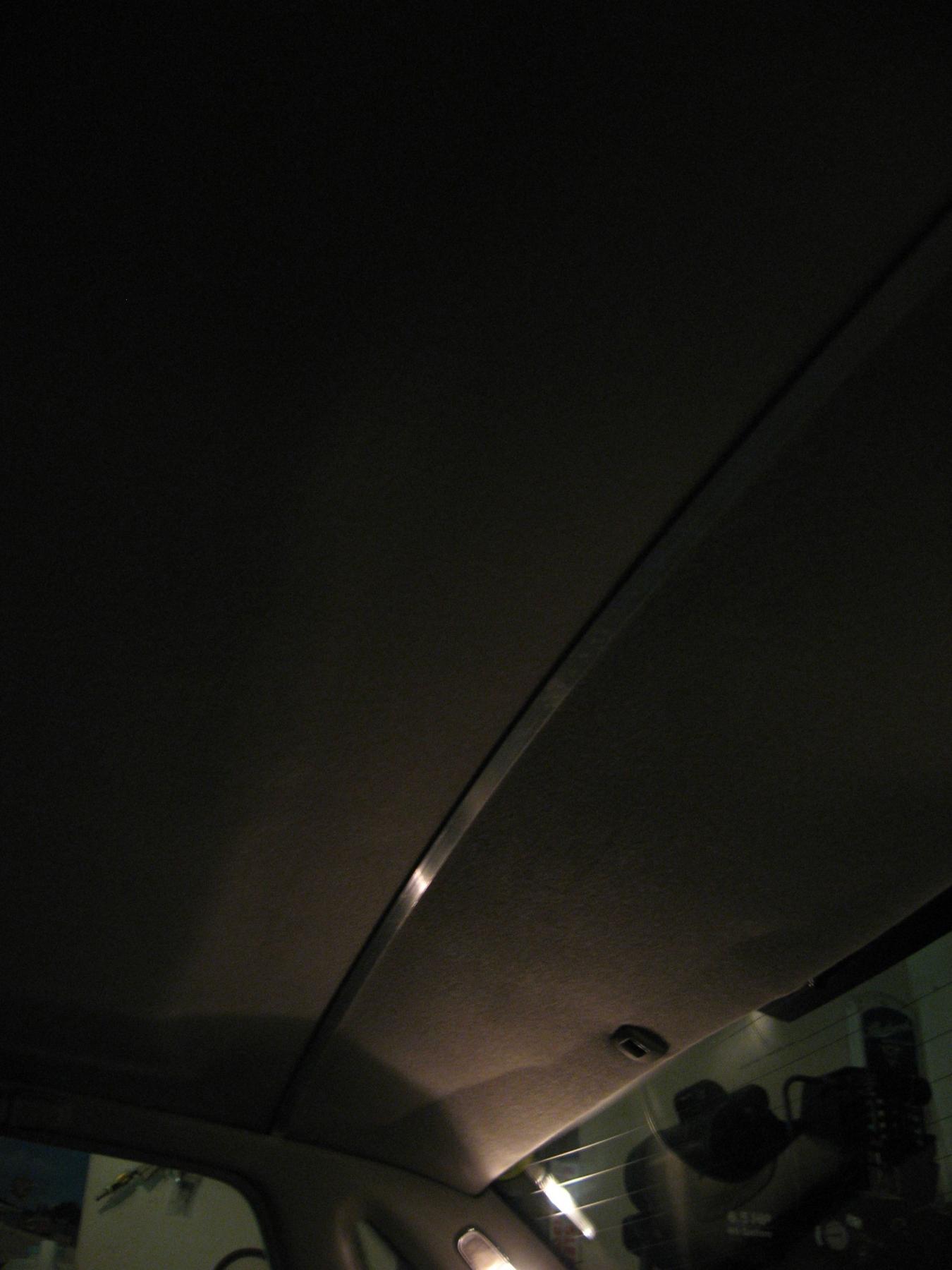

I bought some aluminum stock from my local Ace Hardware.
Paid 5-6 dollars for each piece.
Cut it to length, bent each side, and it just tucks into the trim.
Had to use the flash on my camera this evening, and the pics don't really do this justice.
The metal bar really does not stand out. I have had people look at the car, and they haven't even noticed it.
At least it isn't hanging down and flapping when I have the windows down.
I didn't like the option of pins or those screw in upholstery screws.
I also didn't want to try to spray any glue and try to fix it in place.
This is a cheap and easy TEMPORARY fix that looks okay.
I MIGHT add a second bar.
I also MIGHT take out the bars, prime and then paint with AGD vinyl and leather paint.
These metal supports don't cause any damage at all.
This will buy me some time to do this right, as I plan on keeping my XJR forever.
Stewart
p.s. Here is a pic without the flash:

I like Stuart's fix. From what I saw and although the pictures are not great it looks like a pretty clean, creative solution.

Then I am going to prime and paint the bars AGD.
Once done I'll take some pics in daylight so you can see how it came out.
My car isn't a show car (yet
) but the idea of using upholstery screws or pins really doesn't appeal to me. Somewhere else on this forum I saw someone who used pieces of wood, like I am using the aluminum, and it actually looked nice.
I just want my headliner to look okay while I get other stuff done.
I have not decided to tackle the headliner myself or to farm it out.
Stewart

Stuart i agree with you...i am not crazy about the push pin solution although it came out pretty good on my car.....it is infinitely better than having a sag back there.
Your solution looks good and has a factory finish feel to it.....I am wondering if by adding a second, would you be over doing it?
I would rather(and i think you agree) effect a repair that provides a reasonable solution to the" sagging headliner problem" at low cost and use the money saved (400-600 bucks from posts i have seen here) to address other potential mechanical,electrical or brake system issues that inevitably arise in the course of using and enjoying the car! regards robert
