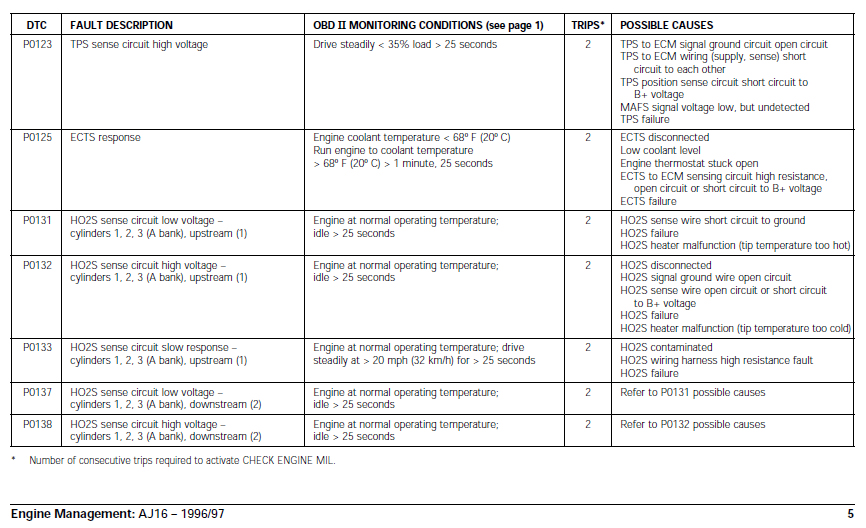

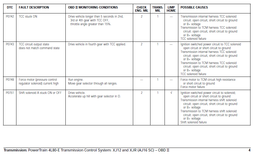

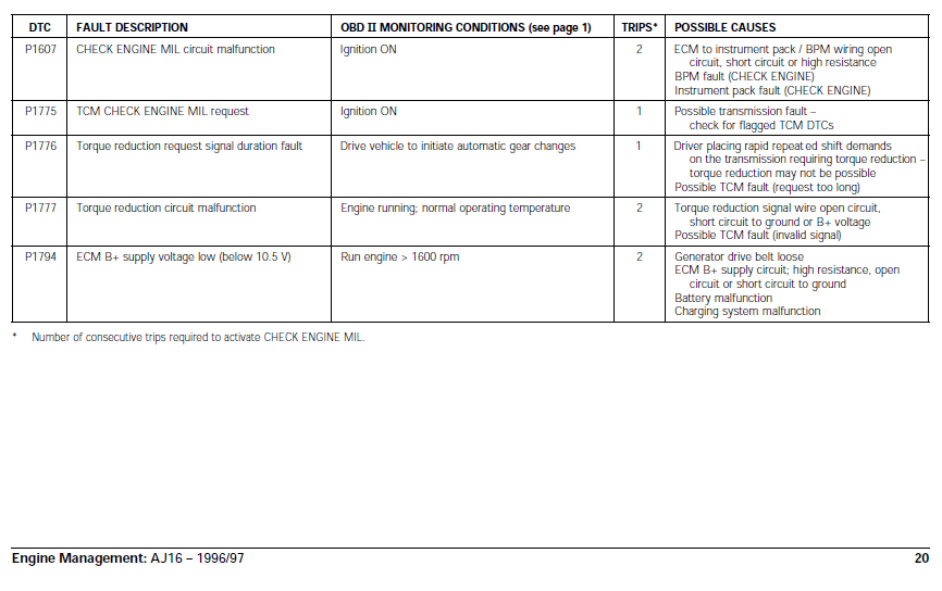

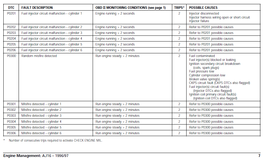

Any chance you downloaded the JTIS from the forum links and made your own CD? It has all code descriptions and gives you some places to start looking. I'll print-screen for you, but if you're going to work on it yourself, you definitely need the JTIS. If you're not computer savvy, go to ebay and get a disc for under $10...well spent I assure you.
I assume, 1995 6cyl SC..
Attached Thumbnails Scanned my car need help with codes-image1.jpg   Scanned my car need help with codes-image2.jpg   Scanned my car need help with codes-image3.jpg   Scanned my car need help with codes-image4.jpg
