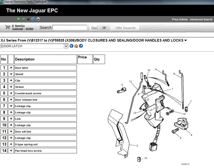

I seem to have a combination of a number of the problems encountered here. The problem started with the driver's door failing to unlock remotely while the other doors did. Then the dash unlock stopped working, followed by the remote stopping working on all doors. Now the key will only open the driver's door.
I tried reprogramming the fobs but I think the instructions were for a 350 XJ8 and didn't work.
The locks make a thunk-thunk sound and the interior lights go on, but nothing is activated.
At the end of my tether with this car. so any suggestions would be gratefully received!
Old Jan 18, 2015 | 06:53 AM
  #30
Neil,
There's a lot going on in the Door Latch assembly. The relevant page from the Parts Catalogue shows and lists the various linkages:
From your description of the sequence of events, I think:
1. initially on the driver's Door Latch only (because the rest worked), one of the linkages was sticking or a microswitch had failed.
2. reprogramming with the wrong procedure has lost the fob to locking module setting.
I would start with new fob batteries and a correct reprogram of the fob(s) then remove the driver's door card to check the Door Latch and linkages.
If it's electrical and not mechanical, the microswitches are available separately. Just as well - the Door Latches are a terrifying cost!
