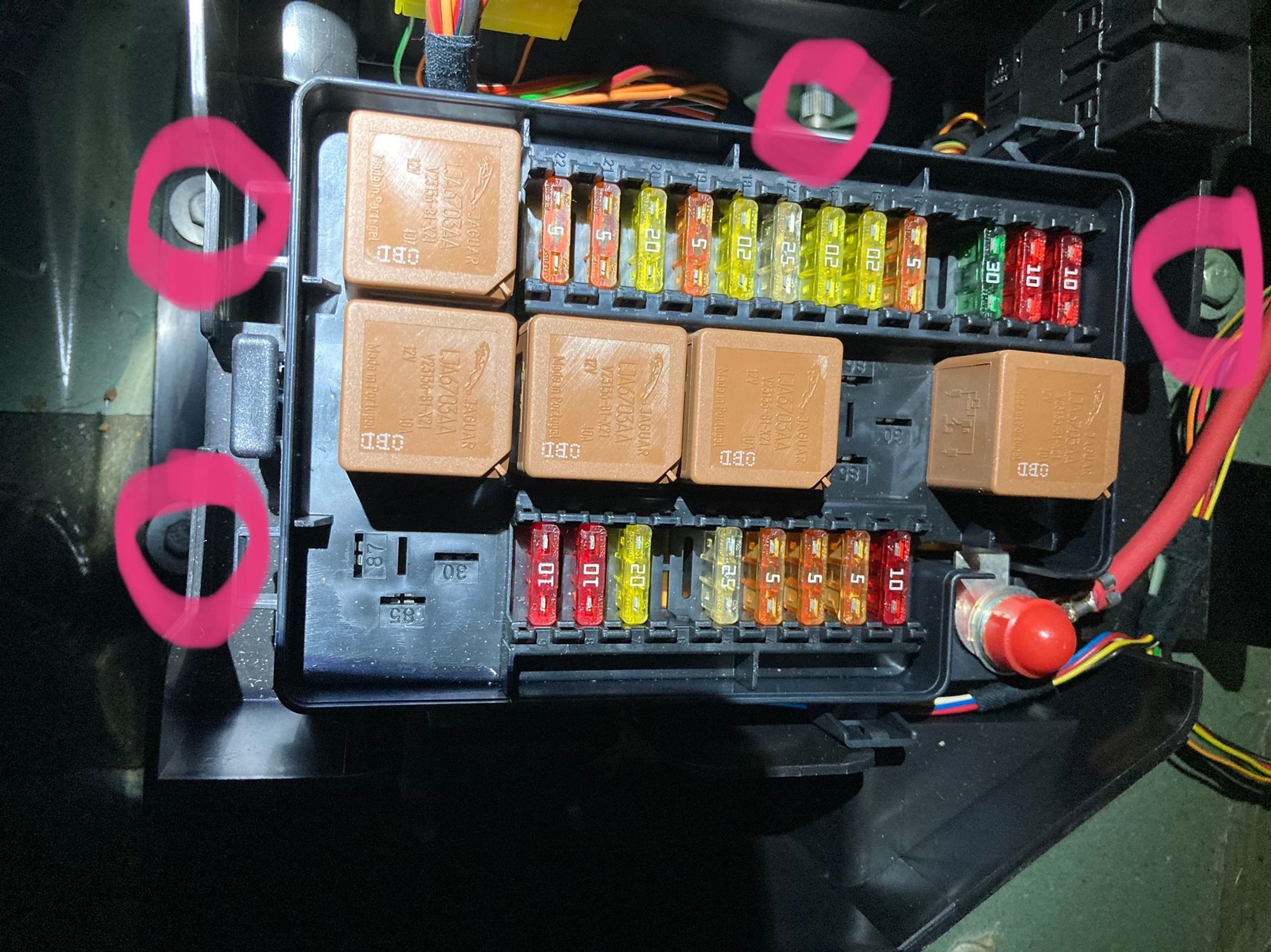

Old Feb 14, 2021 | 06:15 PM
  #52
Addicted2boost's Avatar
Posts: 3,125
Likes: 1,280
2 bolts on the left and 1 on the right need removed. The one at the top is the fob antenna that needs to be unscrewed after you get the 3 bolts removed that hold the entire assembly in place.
It says: SLM 315mhz
