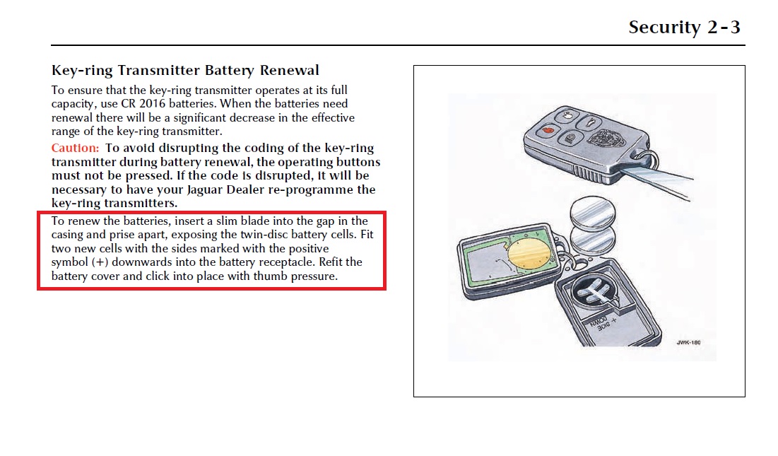

I have same problem, done everything I can think of, what is the correct way the battery should be installed ?, could this be a valid point to most of these questions.
Can someone post correct battery insertion method is: what face goes up and what face goes down against the copper circle on the circuit board.
thanks.
Old Jul 28, 2013 | 05:51 PM
Originally Posted by lukie
............. Can someone post correct battery insertion method is: what face goes up and what face goes down against the copper circle on the circuit board.............
Fit two new cells with the sides marked with the positive symbol (+) downwards into the battery receptacle.
That's positive down as you are looking at the diagram.
Attachment 49490
