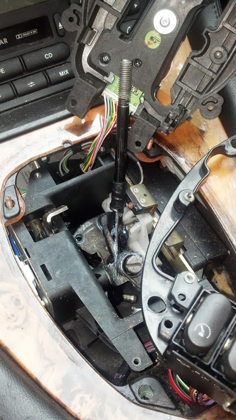

sorry for the delay, car has been sitting as I have been swamped.
So I need an entire J-Gate to fix this?
Attached Thumbnails shift lock solenoid/ J gate dust cover problem-img_20130625_092638_619.jpg   shift lock solenoid/ J gate dust cover problem-img_20130625_092541_849.jpg
Old Jul 19, 2013 | 02:27 PM
flay's Avatar
Posts: 365
Likes: 71
From: Romania
Where is the rotating disc with the brushes? and did your micro-switches have some little arms, like a piece of thin tin blade, that is pressed by the shifter and then it press the little button? The rotating disc is pressing also a switch.
If it looked like this, as it's in the picture, somebody deleted some parts of your J gate and possible the switches are out of their mind.
Try to find an ebay replacement.

missing micro switch's metal tab on top right of J

Thanks everyone, got a replacement j-gate from the classifieds here. I could then see what was missing and got it all sorted.
