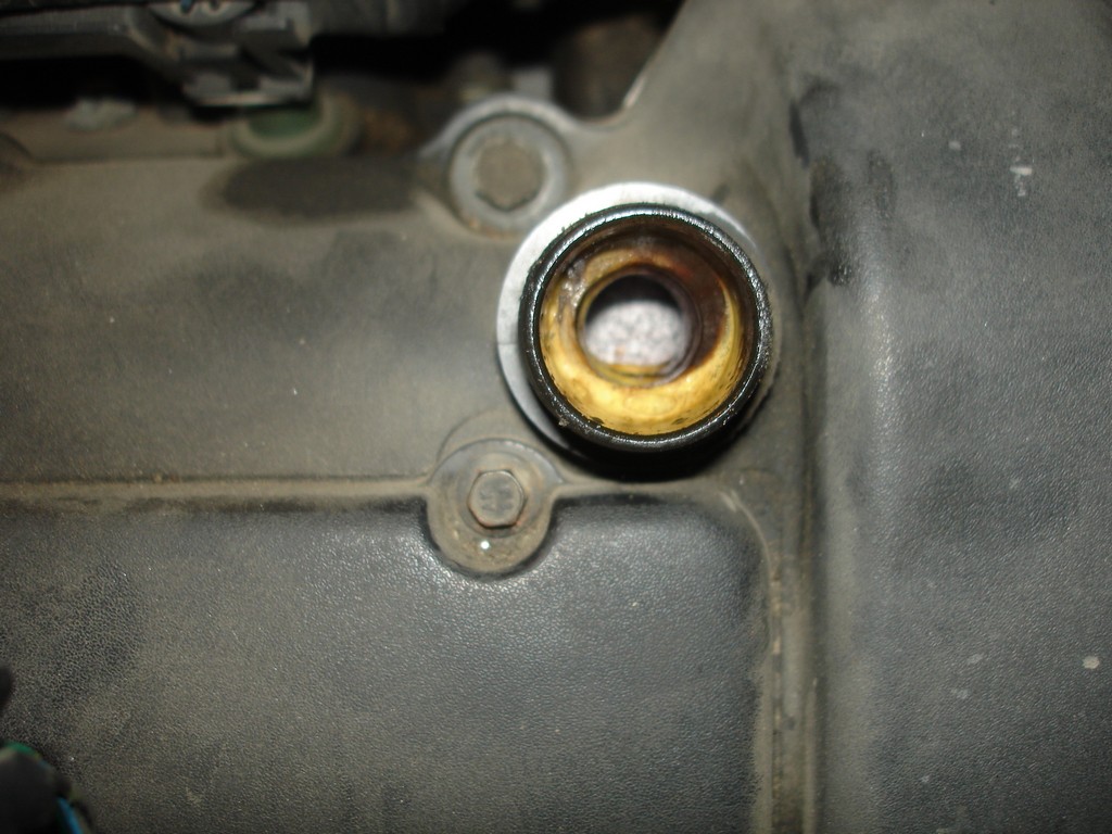

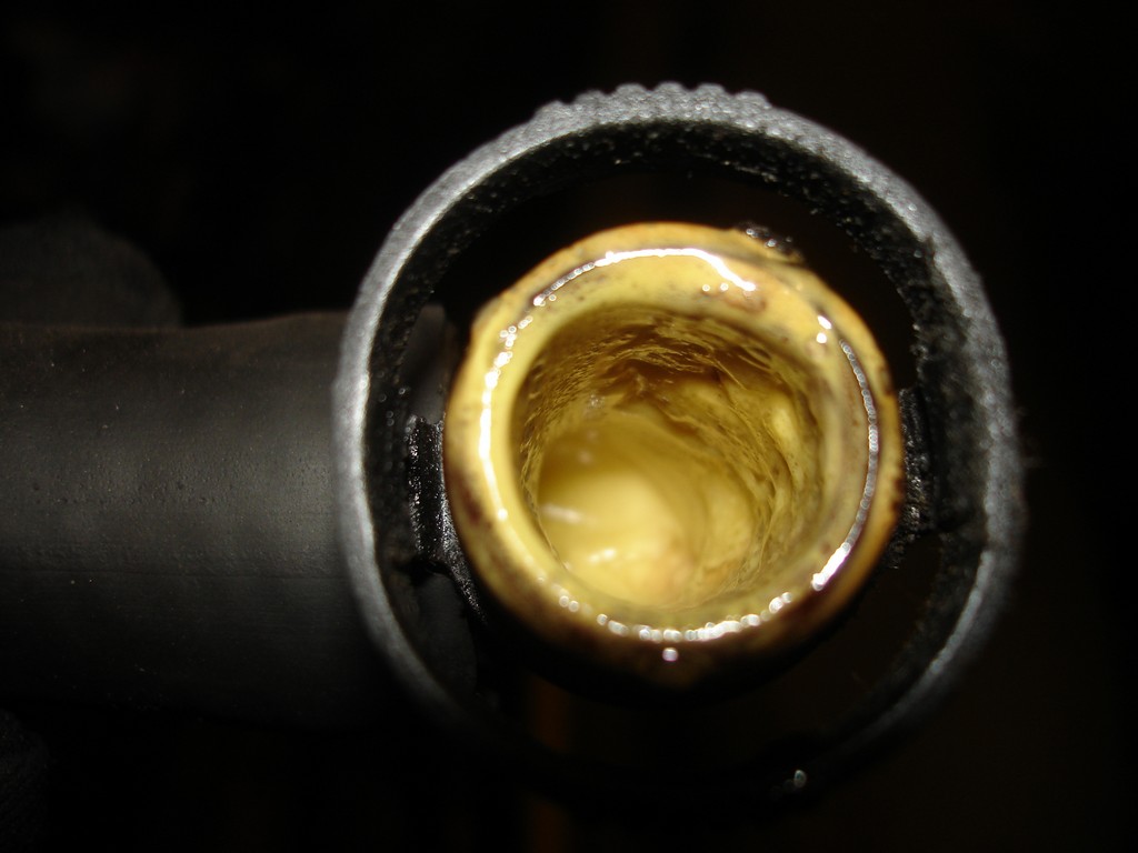

Take the breather hose off to open up the air filter box, and this is what I find. BTW, this is not the first time I've seen this, but it's unusually more "messy" this time:

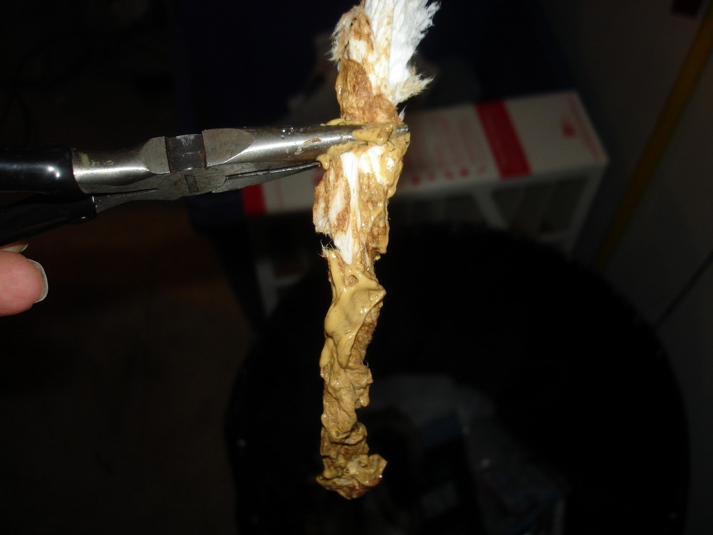

Ran a paper towel through the tube, and this is what came out:
It's basically a mixture of oil and water.
Is it possible that there is so much condensation going on in here that this is happening. I park outside in Kansas City winter, so its not optimal conditions for the cat I know. Also, what exactly makes oil get in there?

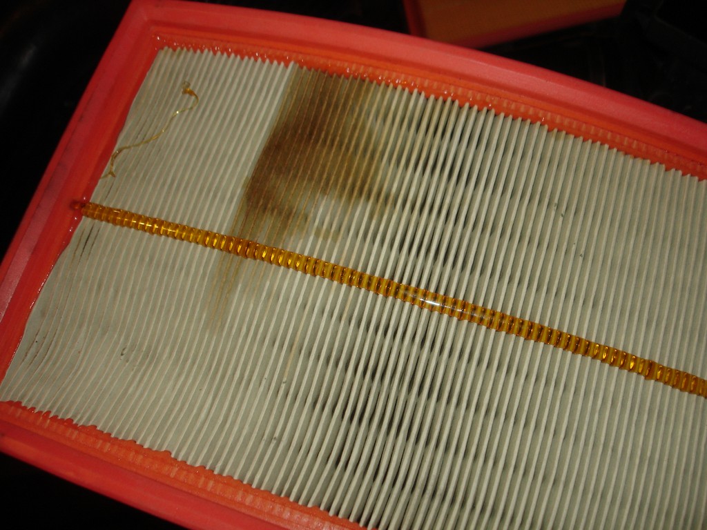

Probably not too good on the MAF sensor:
Definitely not good for the air filter:

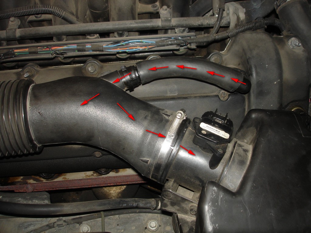

Most of the slime ends up going downwards to the air box, and past MAF. Some gets pushed toward throttle body. I didn't see any of it in the throttle body though, but then again, I try to clean this at least every 3 months (change air filter every 6 months):
So again, does anybody know what's exactly causing this. PC, oil itself is clean, no discoloration or signs of water contamination.

I've seen condensation in cold weather from these engines, a similar mix on the back of the cap. It looks like head gasket damage, but like you say the engine oil is good.
Is the car loosing coolant? Shortish trips or runs where the engine isn't warmed up to the point of gasing off the water will lead to a build up like this. Keep an eye on the coolant level and see if it's there when the weather warms up.
Not much else to suggest at this point, if the car feels strong? I would maybe get a sniff test done on the coolant, just for piece of mind about head gasket damage. Does it misfire at startup, has it got a lumpy idle?

The car does have a coolant leak, but it's coming out one of the "norma" connectors on the "octopus" hose behind throttle body. I have another thread about that. The oil level (and clarity) is checked on monthly basis, and there is no weird discoloration at all, other than normal wear and tear. That rules out the coolant getting into the oil.
Last time I took valve covers off was about two yrs ago. The oil separator was still there, in it's designated place.
No incidents of overheating since I've had the car (2004).
My usual daily trips are 15~25 miles one way. Plenty of time to get the car fully warmed up. I try not to "stomp on it" too often, but I don't shy away from it either...
Part load breather get's checked about as often as I change the air filer (6~8 months). It was a little dirtier (clogged) this time around, so maybe that explains the more than usual amount of oil and moisture in the full breather. I plan on getting new valve covers and gaskets as I'm experiencing oil leaks and consequent burn off onto exhaust manifold...
