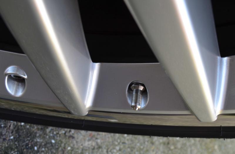

If I take that screw off, will the air come out right away?
NO - the cap conceals the recessed valve. You will not lose air by removing the cap.
To inflate the tyre, you need to screw in a valve extension:
This is on my Sepang but other split rims are similar.
Attached Thumbnails So today I find out I need to spend 0 just to check my tire air pressure-dsc_0074.jpg

Originally Posted by GGG
NO - the cap conceals the recessed valve. You will not lose air by removing the cap. . . To inflate the tyre, you need to screw in a valve extension. . .Graham
Even though I have the complete original leather pouch kit with the two valve extensions and one spare valve cap, I just picked up 4 each of the caps and extensions because it seems they are becoming scarce. I found original BBS parts on eBay by searching for BBS valve stem adapters and BBS valve stem caps.
