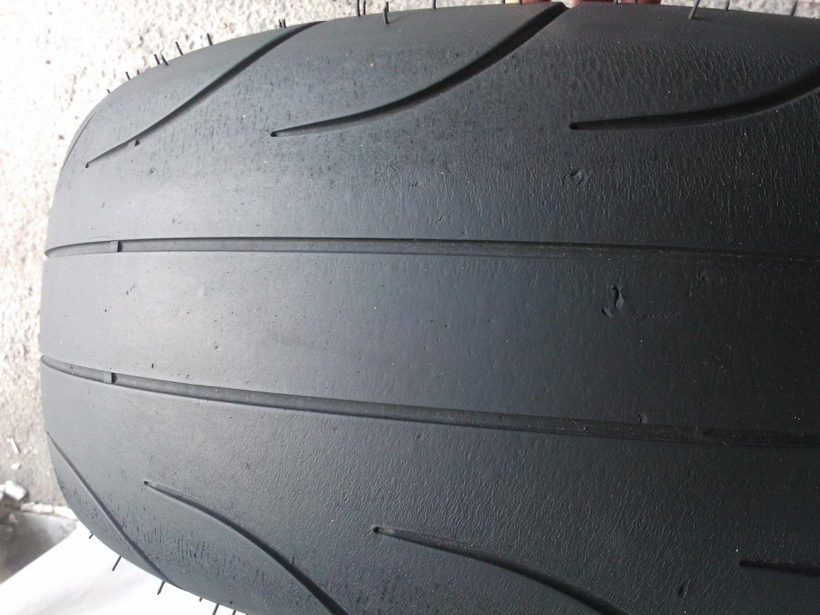

Tires should have better grip now. They were maintained with tire softener by five times. Waiting for Saturday's 1/4mile and a bit better airfield track. Target with current "low" boost: 12.5X / 113. That requires ~1.95s 60ft.
