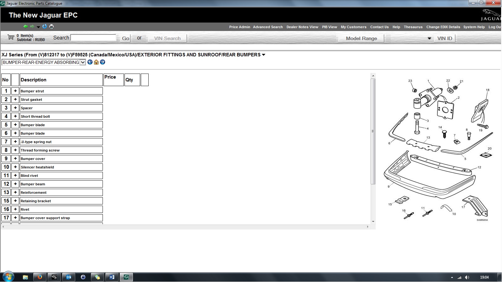

Someone backed into the rear bumper of my 2002 X308 XJ8. The witness said they heard a decent crunching sound when it happened (in a parking lot)
I cannot see any visible damage, BUT, the bumper is loose in that it can slide forward and backward a further distance now.
How do I remove the rear bumper,
and
How do I check the mounting mechanisms for damage??

Sorry to hear about the accident.
US spec vehicles have energy absorbing bumper struts (item 1). If the bumper cover itself (item 9) isn't damaged but moves, the strut could have been broken by the impact.
Someone bumped into the back of my 2002 X308, how to check bumper mounts for damage?-x308-rear-bumper.jpg
Here's the relevant JTIS section on rear bumper removal.
JTIS - X308 Rear Bumper.pdf

Removing the bumper is not difficult, ( providing nothing is seized up ) if you look up from underneath just inboard of the tail pipes there are 2 holes, inside these are a 17mm ( I think, maybe 18 or 19 ) bolt .
Undo these two and the bumper pulls off rearward. Disconnect the side marker lights first.
