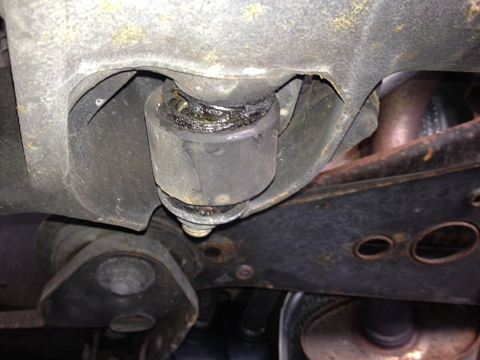

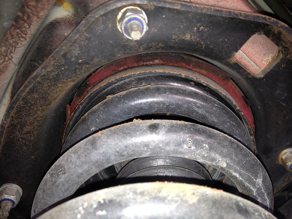

Old Sep 4, 2013 | 02:09 PM
Brettl's Avatar
Posts: 173
Likes: 13
From: Pittsburgh, Pa
Pictures of upper and lower. The upper is crumblinmg away seems like. It falls off in my fingers. Enlarge the pics to see what I mean
Attached Thumbnails Sounds like something flopping around....-upper-bushing.jpg   Sounds like something flopping around....-lower-bushing.jpg
Old Sep 4, 2013 | 02:50 PM
Brettl's Avatar
Posts: 173
Likes: 13
I Still find it odd that a car with relativley low miles that the bushing are worn out? How does this happen I am confused?
I bought the car from Florida would the sea/Salty Air help deterioration?
Old Sep 4, 2013 | 04:05 PM
Cabezagrande's Avatar
Joined: Jun 2012
Posts: 288
Likes: 98
From: KC
A lot of it's just age. Rubber and urethane naturally deteriorate over time. And you're right, exposure to salty air will make them deteriorate more quickly, even just sitting still. And there's all kinds of fluids that can get onto the bushings under there, be it a little bit of diff oil from a very slightly leaking seal, grease, what have you. Basically, your car is 16 years old now, things will start to deteriorate just from age. I know it happened to my 2000 XJR. Even though it only had 70,000 miles on it at the time, the front shock bushings were basically shot and had to be replaced, and when I did it made a MASSIVE improvement in how the car drove, and got rid of many of the squeaks/rattles that had been going on. Your case really does sound like the rear upper shock bushing. As it deteriorartes, it allows the shock to wiggle up and down in the mount, and you get a very distinct rattle when you go over bumps that move the shock quickly up and down. One other thing you may check is your front swaybar bushings. They can produce a strong rattle if they are deteriorated, and it's surprising how far back in the car the sound can seem to come from, as the chassis wil transfer sound a surprising distance rearward.
