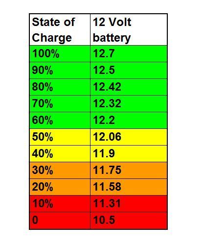

As you put a charger on battery it can read 12.85 volts after full charge ( charger clamps removed ) until it settles out after a short maybe 10 minute period of time ( equilibrium )

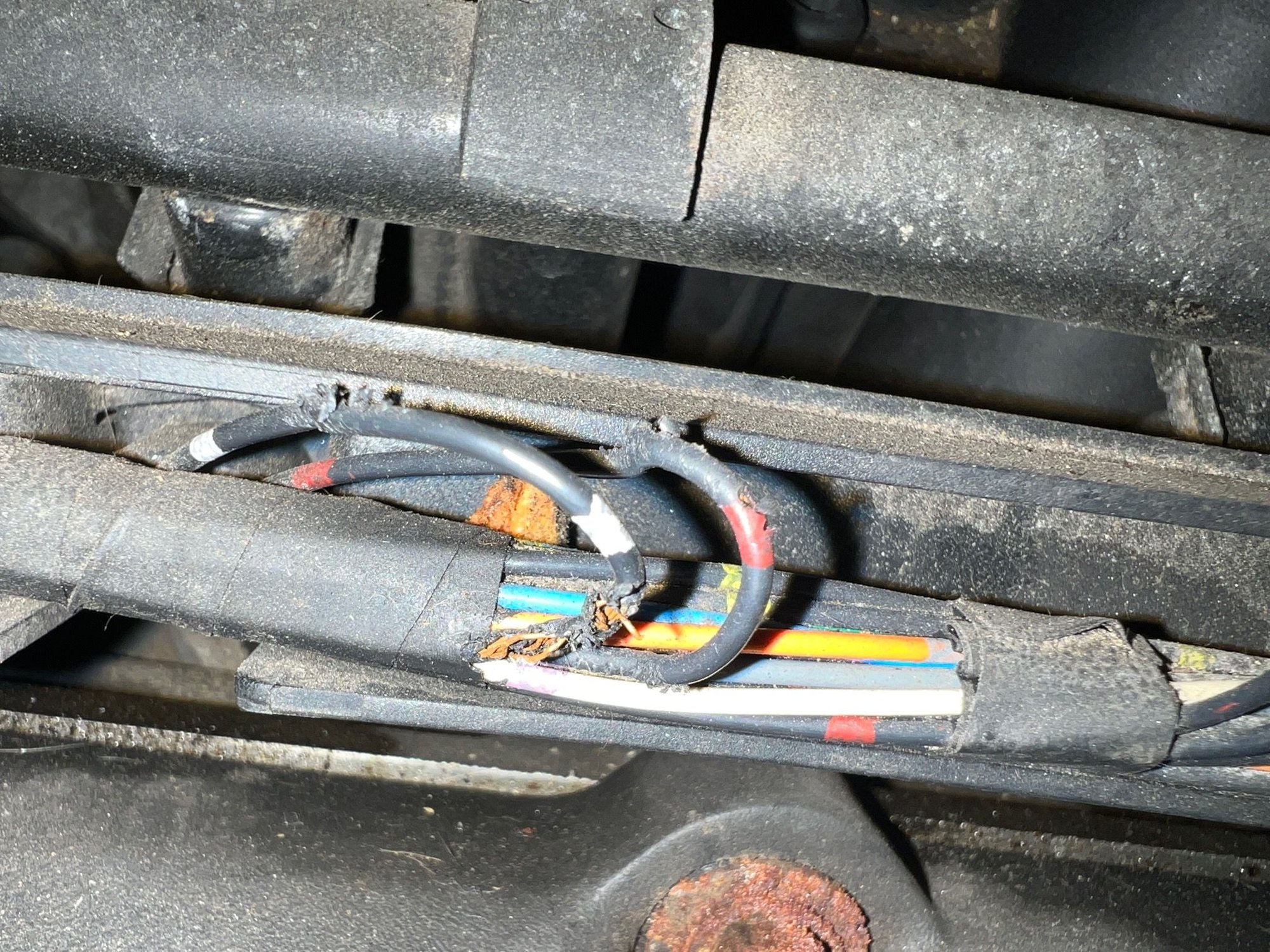

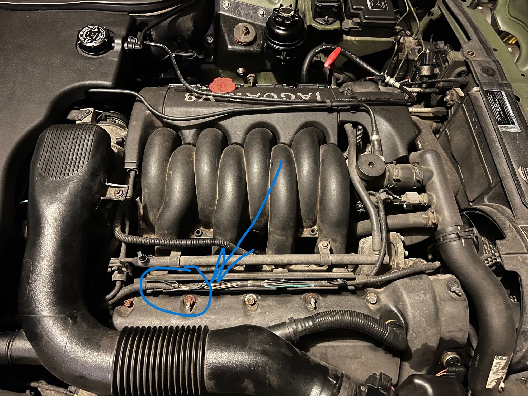

So I was doing more looking around the engine and found the above.... looks like a mouse or critter was doing some biting of the wire... Maybe some moisture wet this when I had the hood open however the engine covers were over this area and didn't spray near this wire. Regardless, can someone let me know best way to handle this wire and if this could possible be my answer?
Thanks

As long as you have good continuity, it would be ok to do a repair.
The main thing, of course, is to prevent water intrusion, so sealing
the rift with acrylic adhesive, RTV, or similar silicone is the 1st step.
Then, you can further protect the damaged areas by electrical tape
or plastic wrappings of your choice.

Thanks. What would be the best way to test continuity? The wires inside looks minimally torn apart but seems like they are beginning to corrode/become weathered.

The first thing to do is visually check that the suspect wires are not broken.
If some strands are broken but the wire is generally intact, the wire can still
be used or repaired (soldered) at your discretion. Then, patch the plastic
shielding, using Duct tape or your preferred method. If rodents are the
suspected cause, then it goes without saying that issue needs to be addressed
or you will have other issues that will appear without warning.

Thank you, I will further inspect the wires. The stalling issue seems to happen out of no where so hopefully if I choose to repair the wires, I will know sooner than later that this was the issue. Would it be better to replace this harness all together? I do plan to address the rodent situation with traps, mothballs, etc.

To be absolutely forthcoming, there could be a number of places that the culprits
could have damaged. Most of which are not as easily identifiable as the one shown.
My method would be to try the repair and see where things go from there,
