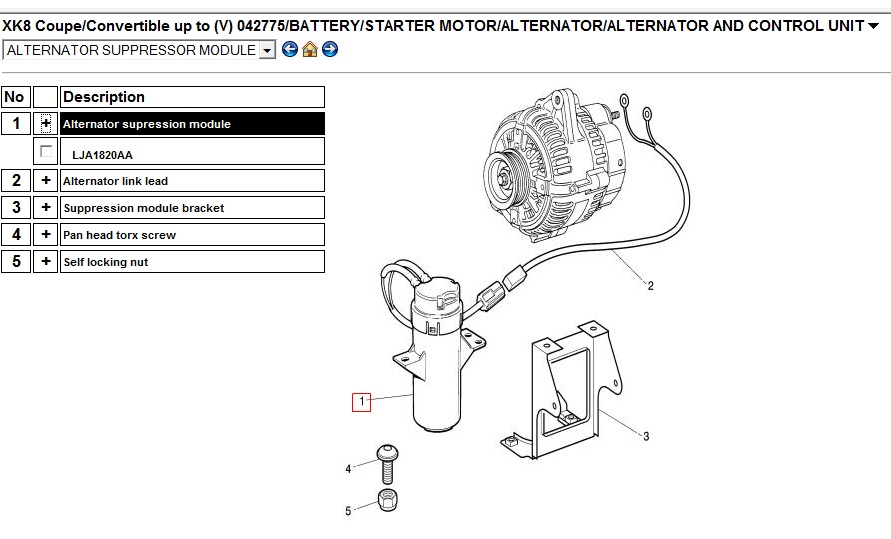

This could be a faulty Alternator Suppressor or it's harness:
Strange noise coming from audio speakers-xk8-alternator-suppressor-module.jpg
It could also be the Alternator itself but this is less likely if it's charging properly.
