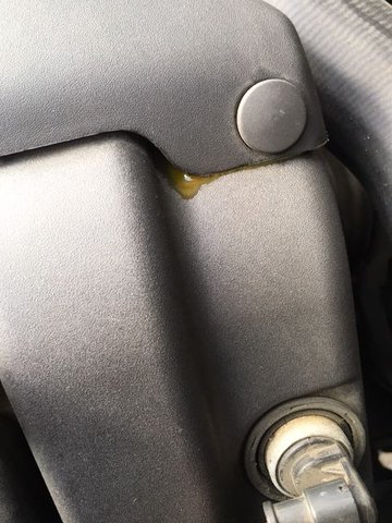

Heard the squeak on cold startup; did not get louder with the A/C nor did it get louder in the footwell. I heard it come from the left hand side of the engine ( passenger side ) after a minute it went away.
Could it be the alternator with parasitic drain which could cause drag on the pulley because the security system overnight, ect?
My other guess is one of the belts might be getting oil on them. I noticed a little bit on the plastic cover ( see picture ) not sure if that means there's other leaks, ect.
