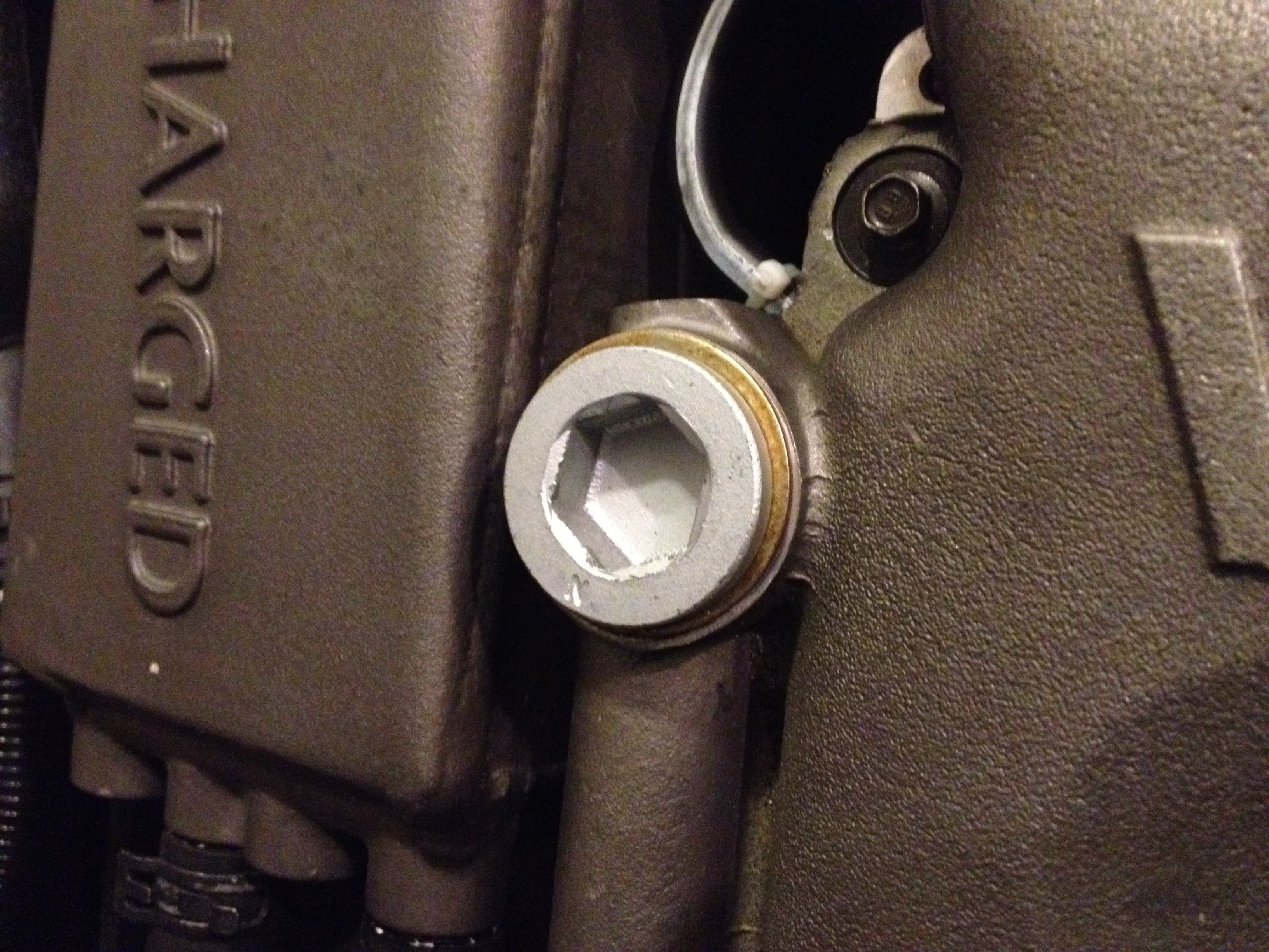

Default This?
Would this be the supercharger inlet?
Old Apr 12, 2017 | 10:09 PM
nilanium's Avatar
Joined: Oct 2014
Posts: 1,465
Likes: 515
From: MD, USA
Yes. You need a 19mm hex socket for that. Since they're not real easy to find cheap, I grabbed the closest 19mm box end wrench I had, stuck a long 19mm lugnut and used that as the "driver." My fill port was a bit gummed up, just since the coolant doesn't flow in that short section between the hose and port, and who knows how much the PO bothered...
Also for the XJR's you can add coolant to the s/c port, snug the cap down, turn the key to ON but don't start the engine, wait 30 secs and turn car off, then repeat. This will turn on the s/c coolant pump and bleed the s/c "loop." For this you want your other coolant port to be filled as well. If I remember the factory procedure right, you do that bleed a couple times, then do the regular system bleed for the engine coolant "loop." Loop in quotes since they're not entirely isolated, but nearly.
