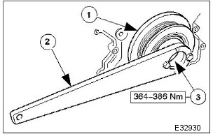

If you have a tool similar to this, do it that way. However the purpose for the cam lock down tool and the flexplate pin to lock the engine in place. I've taken these apart by hand using the cam lock down tools and flexplate pin, never broken a timing chain. If you have all 3 tools in place, there shouldn't be any movement of the timing chain, so no risk of breaking it. As you see below, the torque spec. Once you remove the bolt, you need to clean the threads inside the crank. If you decide to use the old bolt, clean the threads on that as well, or install a new one. Apply some Loctite to the bolt. Then you'll need to find a torque wrench that will go to 386Nm, or close enough. My torque wrench went to 250 ft lbs, then it was after that it was up to my judgement how much tighter to go. I've never had one fail or broken a timing chain using the lock tools, ever.
Tighten the damper securing bolt.
  1. Reposition the damper to allow access to the bolt holes for installing the locking tool.
  2. Install the locking tool (303-01 and 303-01-02) to the damper using the bolts provided.
  3. Fully tighten the damper securing bolt to 364-386 Nm.
