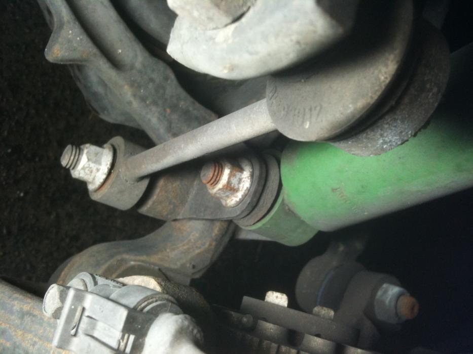

hey what do you all think of these pics...time for new bushings? i went for an oil change last week and the dealer told me no, then i went for a wheel balance to the dealer today and they told me i needed to do my lower control arms...what do you all think

I can't tell one way or the other based on those pictures, I'm just not that versed in good vs. bad visually. BTW, how many miles are on these bushings?

They look pretty dried out but it could just be dust. As was stated it is tough to tell from a pic unless you can see 1/2 of it missing. Why did they say they needed replaced? Is there play that won't allow them to align it? If so have them show ya.

The bushing in the second shot is definitely gone. Search the board on how to remove the lower control arm. I removed the arm and got a local garage to press in the new bushing.
You may notice uneven wear on the tire, esp. the inner edge, as I did.

I concur with Dan R, the bush in the 2nd pic looks the one that is worn, the others look OK. I assume Pic 2 is of the lower wishbone, (aka control arm).

If you are going to have the lower control arm bushings replaced go ahead and have the the ball joint replaced since you will have the control arms off anyway. Depending on labor rates it may pay to replace the control arm as a unit. A new one comes with a new bushing and ball joint installed

yes the bushing in the 2nd pic is broken, this will let the suspension/tires TOE OUT while driving causing inside tire wear. The rear seldom break, but would look similar. Yes the ball joint comes as an assembly of the front lower REAR control arm. Ball joint, arm and new bushing. Unless your brakes are almost metal to metal they can wait. The broken bushings accelrate front tire wear....so you decide, But I would do the bushing first since that cost more money in tires letting it go(again assuming you have pad material remaining) And youll need an Alignment when done

you need a special tool to fit the bushing to "press"it in, yes you need a press. And the ball joint is installed in the rearward front lower control arm from jaguar with a bushing already installed too. I would take out the arm and take it to a jaguar dealer/shop and have the old ones driven out and new pressed in with the bushing installing cup. It keep the new bushing flange from mushrooming and prevents the rubber from breaking when pressing in.
