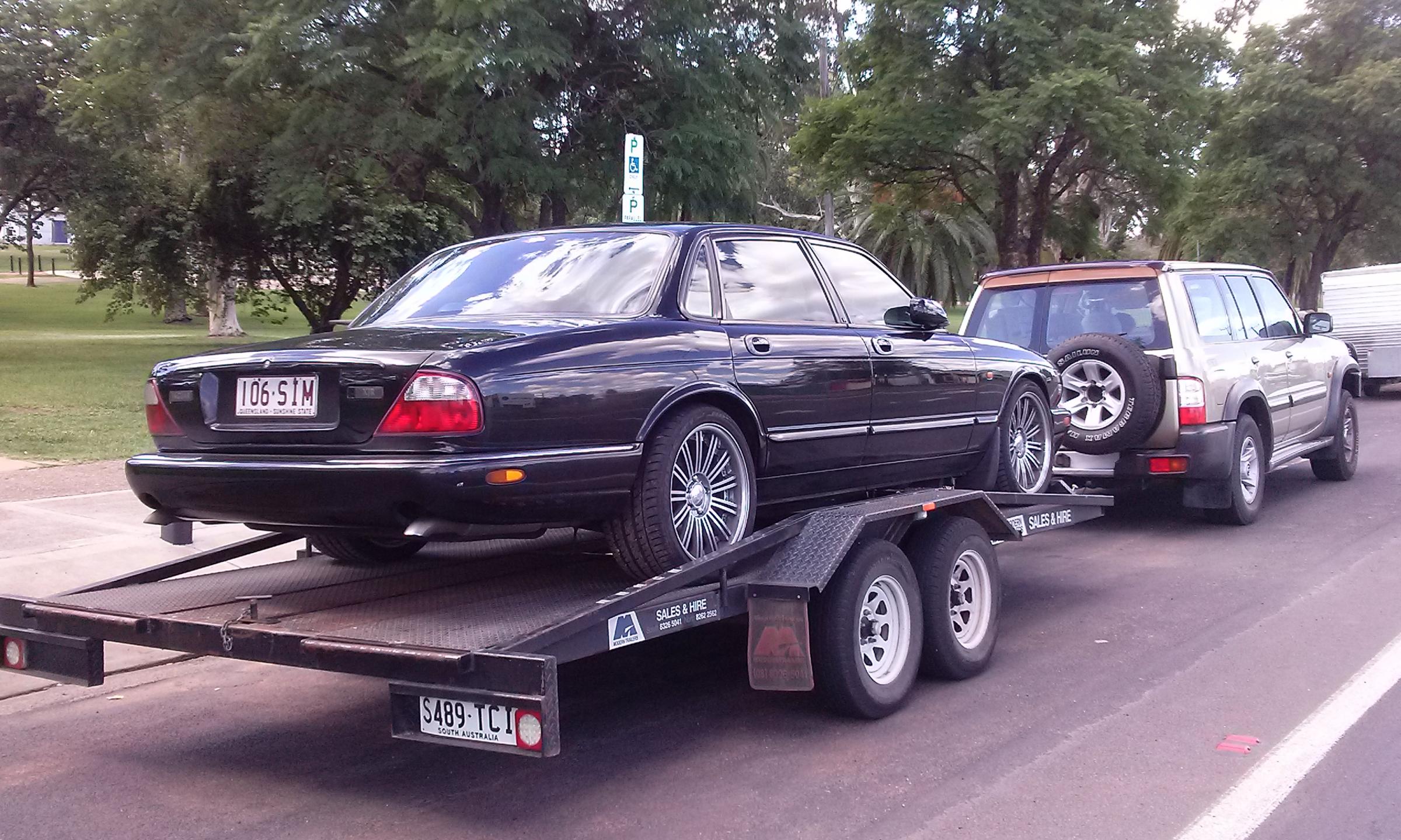

me too Sami -- I blew mine again, my own fault - 260KMH
But I was 4,000km from home, had to buy a car trailer and 4 wheel drive to get it home.
My problem was detonation, I need to fit a after market Piggy Back ECU
That's quite far away from home. I had just 85km on trailer. Did you blow your engine ( block or pistons ) or just head gaskets?
