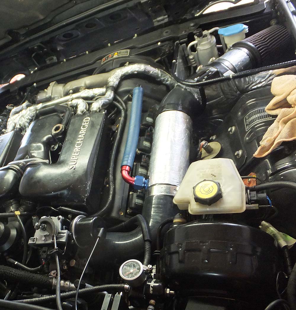

Me too plums, see pic, fuelabs - centre - bottom, Mine runs 53PSI at idle, vacuum port plugged, and about 78PSI at full noise - ( 2x new Denso fuel pumps) It ran lean on the dyno, raising fuel pressure was something I was going to try.
Another thing was to fit a pair of oxy sensor manipulators, same as I have on my Ducati
PERFORMANCE BOULEVARD - O2 Manipulator

dc4Prez:
Please explain how the oxygen sensor manipulators will help if the problem is that the injectors / pumps won't supply enough fuel?

Originally Posted by sparkenzap
dc4Prez:
the flow rate of the pumps, has never been measured, also the injectors have been cleaned, but not able to be flowed in the town I live in. I have an aftermarket MAF, which has a mind of its own.
If indeed the problem is that the pumps or injectors physically can not supply enough fuel - no amount of oxygen sensor manipulators or electronic trickery will alter the problem. The idea of the manipulators was to fool the ECU into thinking it is lean, which in fact it is through all rev ranges, and get it to supply more fuel.
There is an old dyno here on a post, showing around 13.8-1 @3500RPM improving to about 13-1 @ 6,000RPM.
I don't think I've suggested that it runs out of fuel,
Orginal Denso pumps flow 26.45gal at 43.5PSI. Orginal regulator keeps fuel pressure 39PSI ( vacuum }at idle and max 45PSI at full load. SC injectors flow 360ccat 43.5cc, so not much more at WOT. This means that stock injectors with stock FPR can give max 510-530bhp, but that's not safe anymore because of 100% duty cycle.
